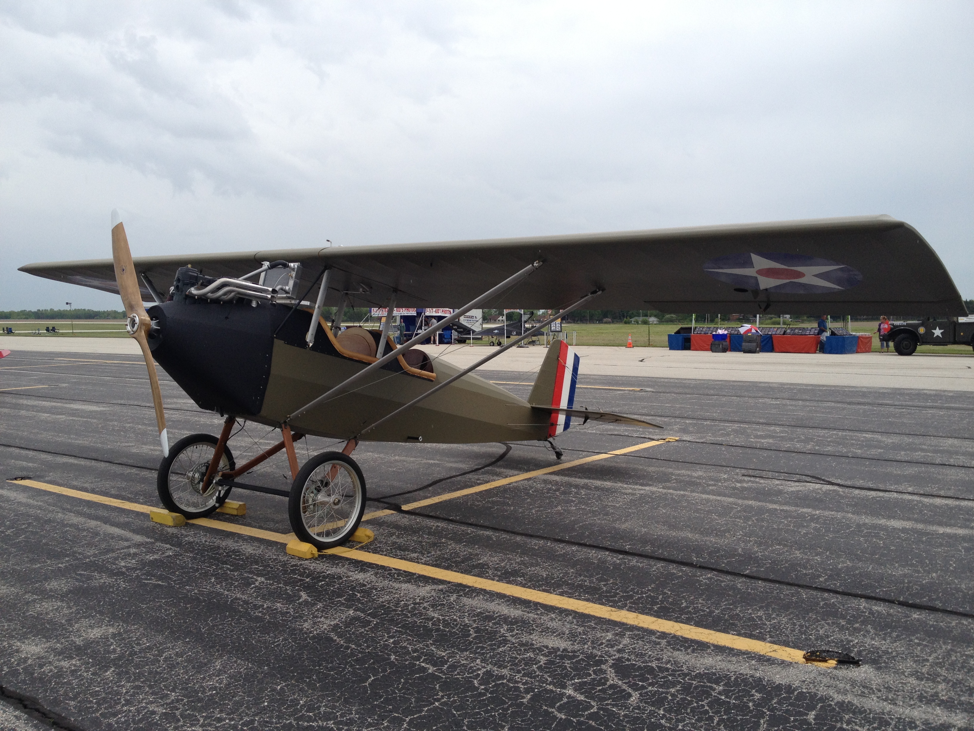

Looking for ides on how the cover up the holes as the cable go thru the fabric
on the fusalage. Im thinking leather patches would be easiest and clean, but how
do you attach them? i assume glue, but what kind. Ive seen some sewn on, but
how do you get to the inside of the fuse ? Pictures/ideas appreciated.

I used aluminum reinforcement with fabric patches for my cable exit holes,
but for the leather patches protecting the stabilizer leading edges from the
chafing of the elevator cables, I just glued the leather on with
Poly-Fiber's "Poly-Tak" glue. It sticks to fabric very well.

Chris-- I used Rich Corinthian fake naugahyde vinyl and followed the instru
ctions on a can of contact cement
and it worked well. After about 10 years of flying the edges of the patch
es started to pull up. I suppose oil, slipstream,
and the elements helped that along.
Mike C.
PS-- for where the aileron cables exit the wing I simply cut a tiny + at th
ose points and they haven't frayed or opened up
at all. Very pleased with how that worked out. Thank you Bill Klosz...aga
in.

Stewart Systems DVDs show an interesting and good way or doing this and you
don't have to buy much (except the DVD). I tried to copy it and attach it
to this E-mail but can't do it. Chuck

Deerskin patches glued on with Gorilla Glue, and coated with leather oil. I
had to remove a couple for my wing repair and they were securely fastened
with the glue.
Gary Boothe

I used Dad's methood for cable exits, Cut out a teardrop shaped piece of fabric
and the leather patch about 1/2-1 inch edge distance all the way around (Fabric
bigger than leather). Sew the leather to the bare fabric with rib lacing chord,
Than cement the leather/fabric patch on the airplane. It will never peel
off.
