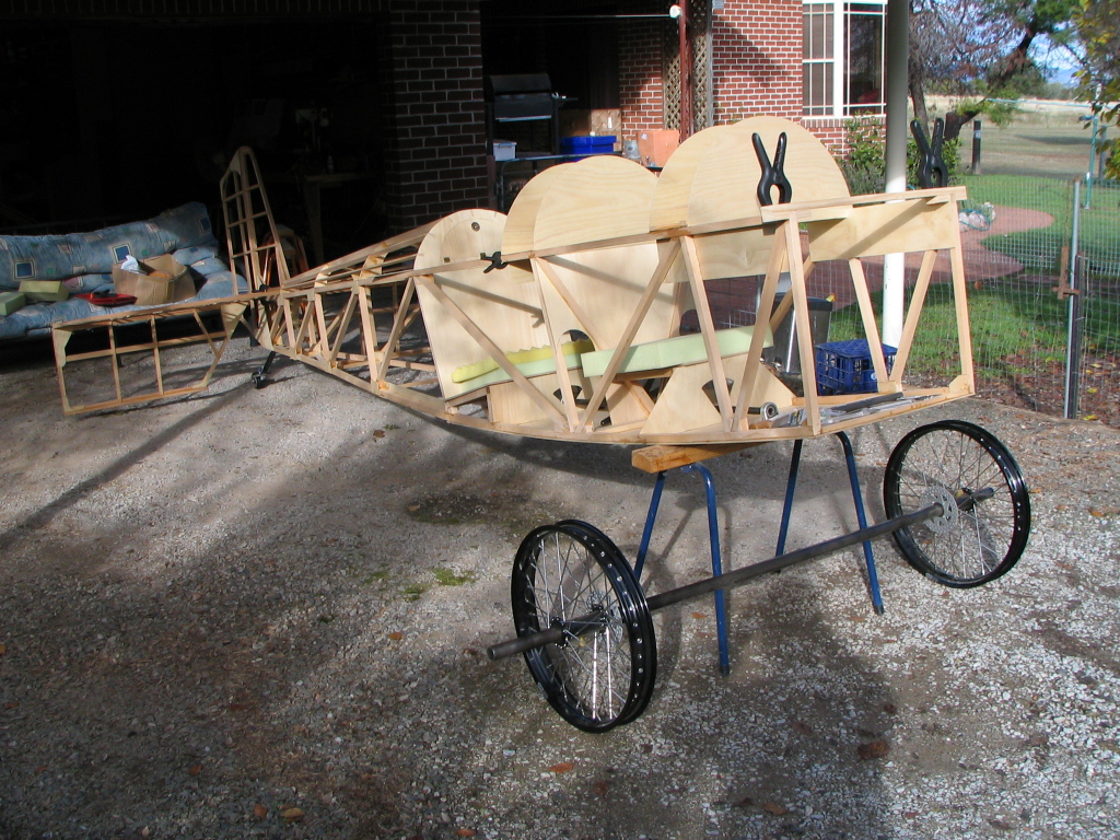

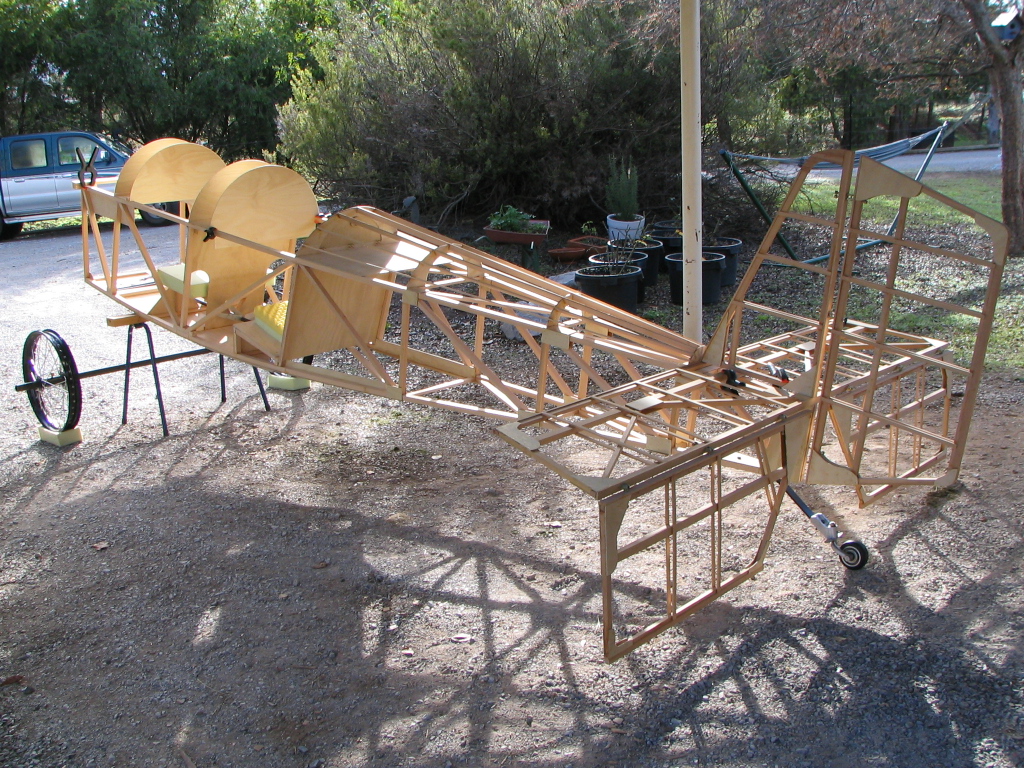

Its been a while since I posted any progress pics on here!
Making instrument panels now and about to start undercarriage.
Scotty
