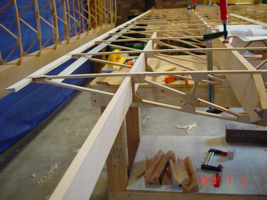

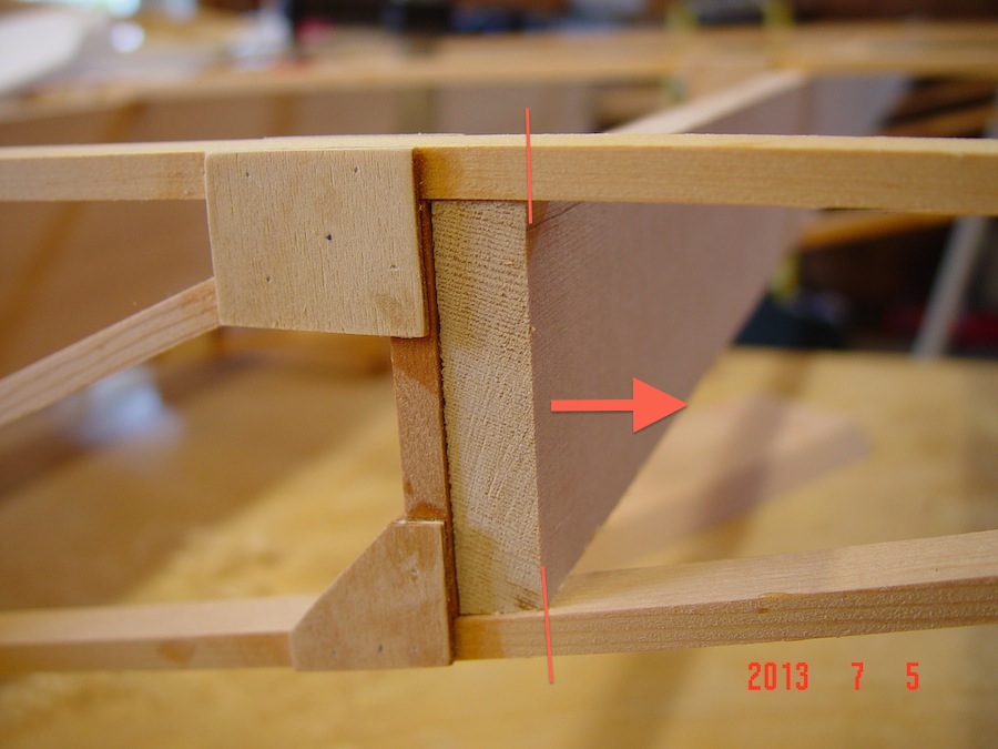

      As I am fitting my aileron spar, I'm wondering with such a tight fit how am I going
      to get glue in it.   I then realize that this is a critical glue joint as
      it appears the piano hinge is bolted to it and at that point the glue on the
      spar is the only thing holding the aileron to the wing!
      To assure a good glue joint, I believe I will fit everything up properly, cut the
      aileron out, then pull the aileron spar straight out and apply glue well.
      Has anyone else done this?
      John Francis
      http://forums.matronics.com/viewtopic.php?p=403986#403986

      John, the final fit will be better if you glue the spars in before you cut
      out the aileron.  What I did was to bevel ever so slightly the spars for a
      half inch just in board of each rib.  Then when I was ready to glue in the
      spars, I offset them temporarily by one half inch.  That give me enough
      clearance to put the glue on the rib surfaces.  I also put glue on the spar
      face and spar top and bottom.  Then a nice, gentle shift of the spars for
      the final half inch, and some clamps to hold things together. Worked easily
      and strong as can be. Cheers, Ken
