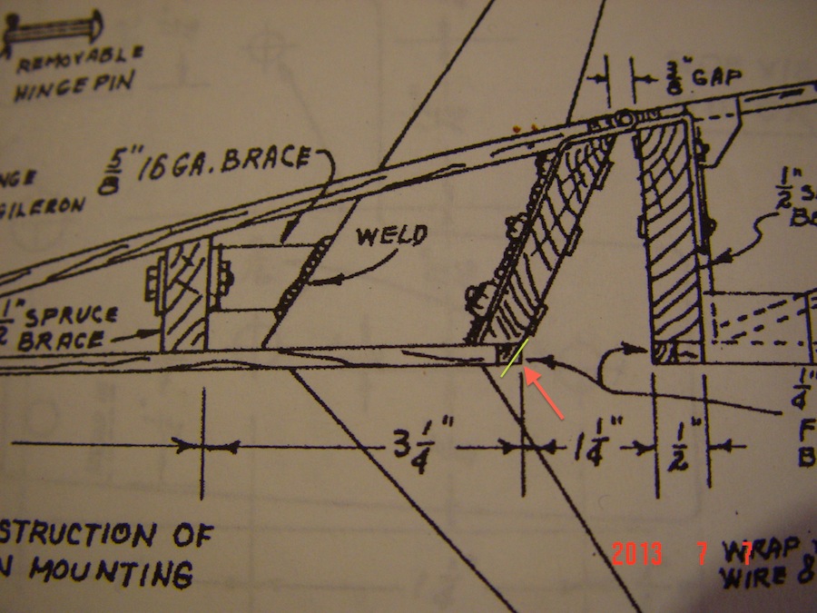

Message 3
      The prints show this area left alone.  I think it would be better if the corner
      was taken off and the surface flush with the entire side.  How have you done
      it?

Message 5
| Subject:  | Re: Aileron shape |
      John, I used a hand plane to make the corner flush with the face of the
      aileron spar.  Cheers, Ken

Message 7
      I flushed it and slightly rounded the edge.
      Gary Boothe
