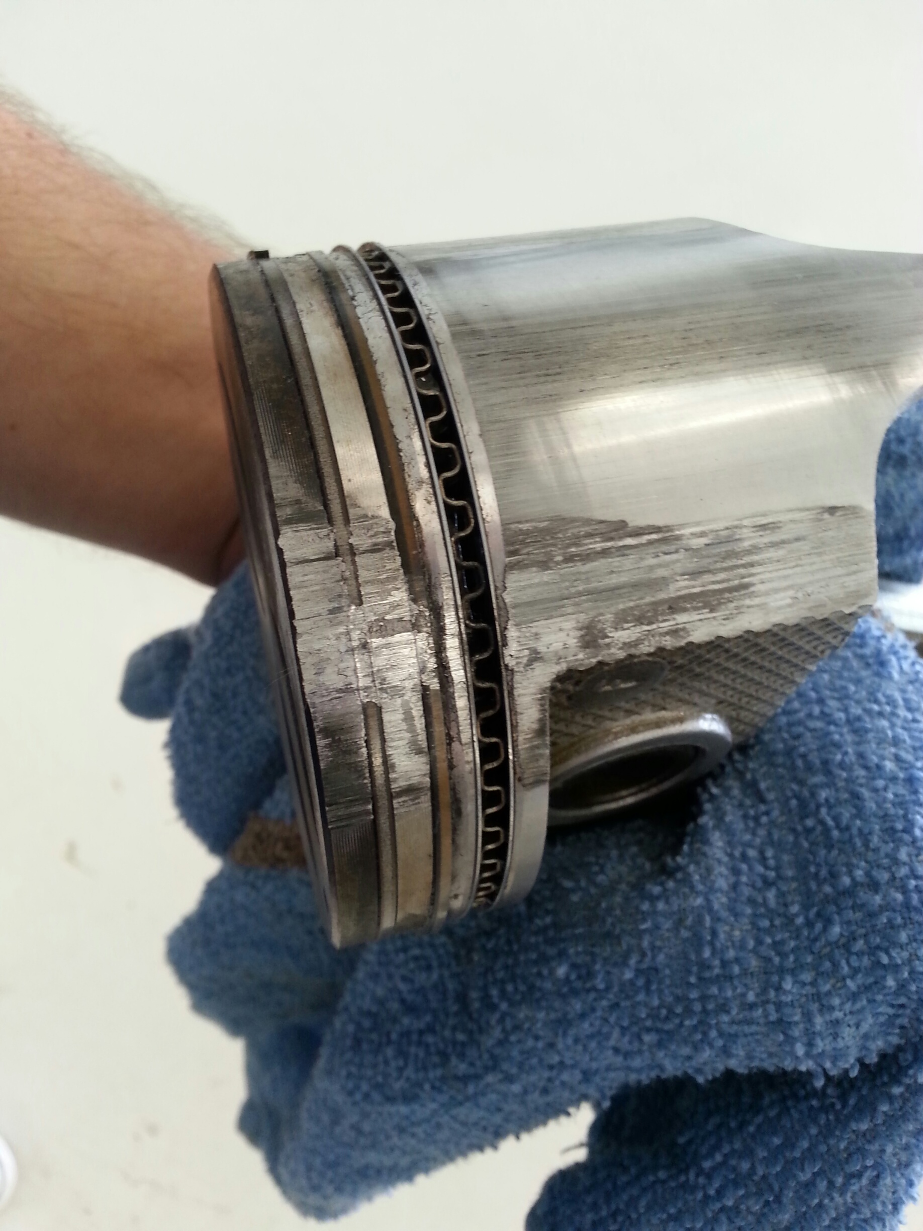

I found the reason that my engine quit..
rear #4 piston melted a bit..
Not sure Why.. everything else looks OK
Now to fix it..
Jeff

Thanks for sharing Jeff. What would cause that? Too lean or something else?

Typically that sort of damage is caused by preignition. You should find the cause.
Is there a helicoil tab or cracked plug insulator? It can be caused by improper
leaning where you stay at the peak or slightly rich of peak for too long.
Do you have a CHT and/or EGT gauge?

Exhaust leak?
Did you verify each cylinder for proper size before assembly? I wouldn't guess
it, but machine shops regularly get that sort of thing wrong. A good friend
of mine was the editor of Hot Rod magazine at the time he rebuilt a Camaro engine
for me. He sent the block off for machining and when it came back, he checked
the crank bearings and found some off tolerance. Had to send it back a couple
times before he was happy.
He was the editor of a national car magazine, if there's ANY customer you'd want
to do a good job for (and it was a well known performance shop in LA), you'd
think it would be him. I just assumed when you send something like that out,
it would be right. He said that was pretty normal... For a really good engine
build, you have to verify all that stuff yourself he always told me.
Doesn't usually result in catastrophic failure, but will easily affect how long
the rebuild is good for.
Wouldn't have to be too much too small to cause that... Perhaps something as simple
as that cylinder wasn't honed as much as the others. Maybe ring gap too
small? Would heat that cylinder up a lot more, with corresponding piston swell.
Nice to know what happened in any event.

Jeff I don't claim to be any kind of expert, having burned up a piston on a corvair
myself I don't think that is Detonation, or pre -ignition. I know mine was
burned by detonation, and looked nothing like that. It looks like friction
heat due to ??? wrong bore for that size piston, rings??. Did it lock up on
you and quit, or did it start running rough then quit? I will look again and
see if anything comes to mind. See the attached pictures of the piston I blew
up during ou growing pains. Eventually found that a helicoiled spark plug hole
caused ours, it was very intermitent, and would run fine and out of nowhere
start loosing power (detionation). Send me a picture of the cylinder wall and
head if you can.
Shad Bell

Doesn't seem to be a lean problem. . . The guy that built the short block looked
at the photos and said heat or lack of oil. .. or both. . Ring gap was fine.
It kinda looks like the shooting started on the lower part of the skirt.
My oil pressure was down to 2-3 lbs when this happened. .
Modding an oil pump for flow and pressure now. . According to a service bulletin
from November of 1932
Jeff

Looking at the second ring, above the melted place, there is a lot of metal built
up below the ring. Looks like there was more damage than just at the melted
place.
