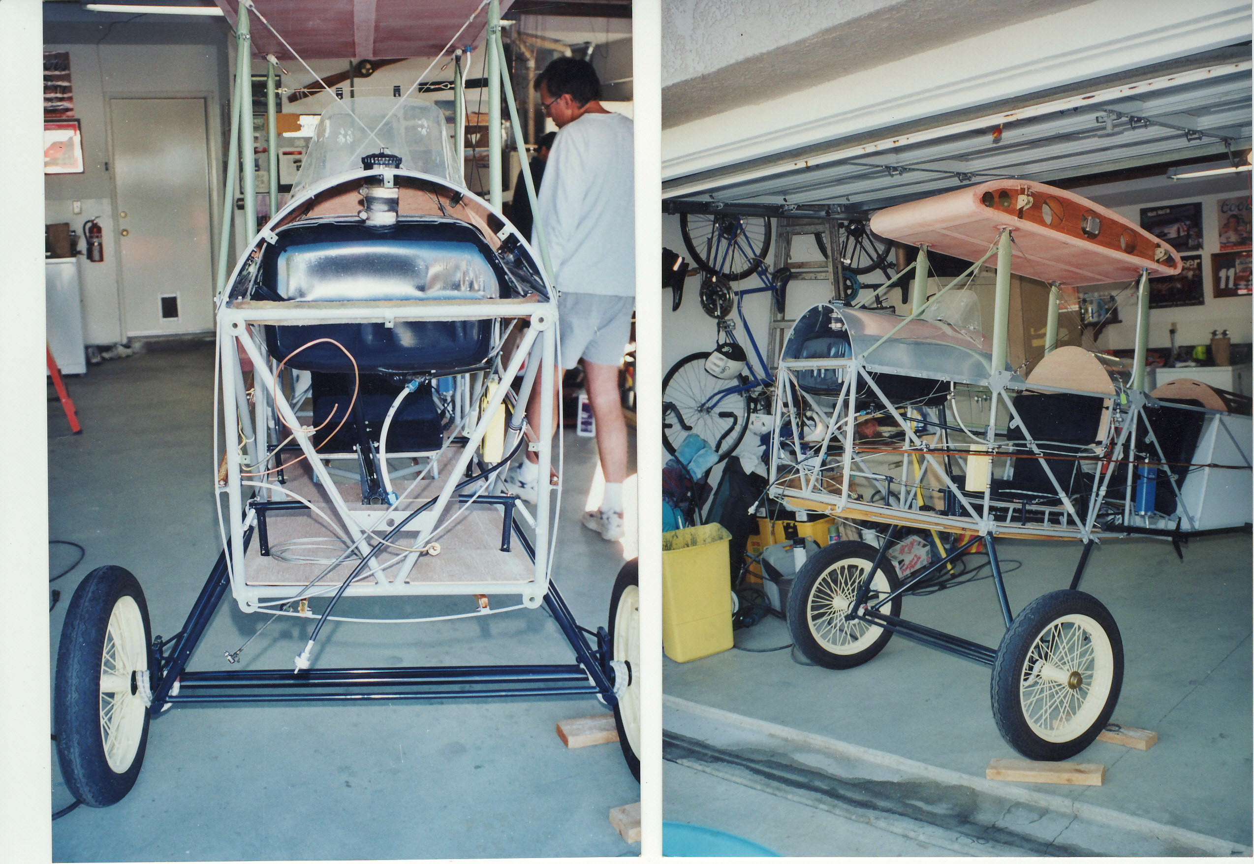

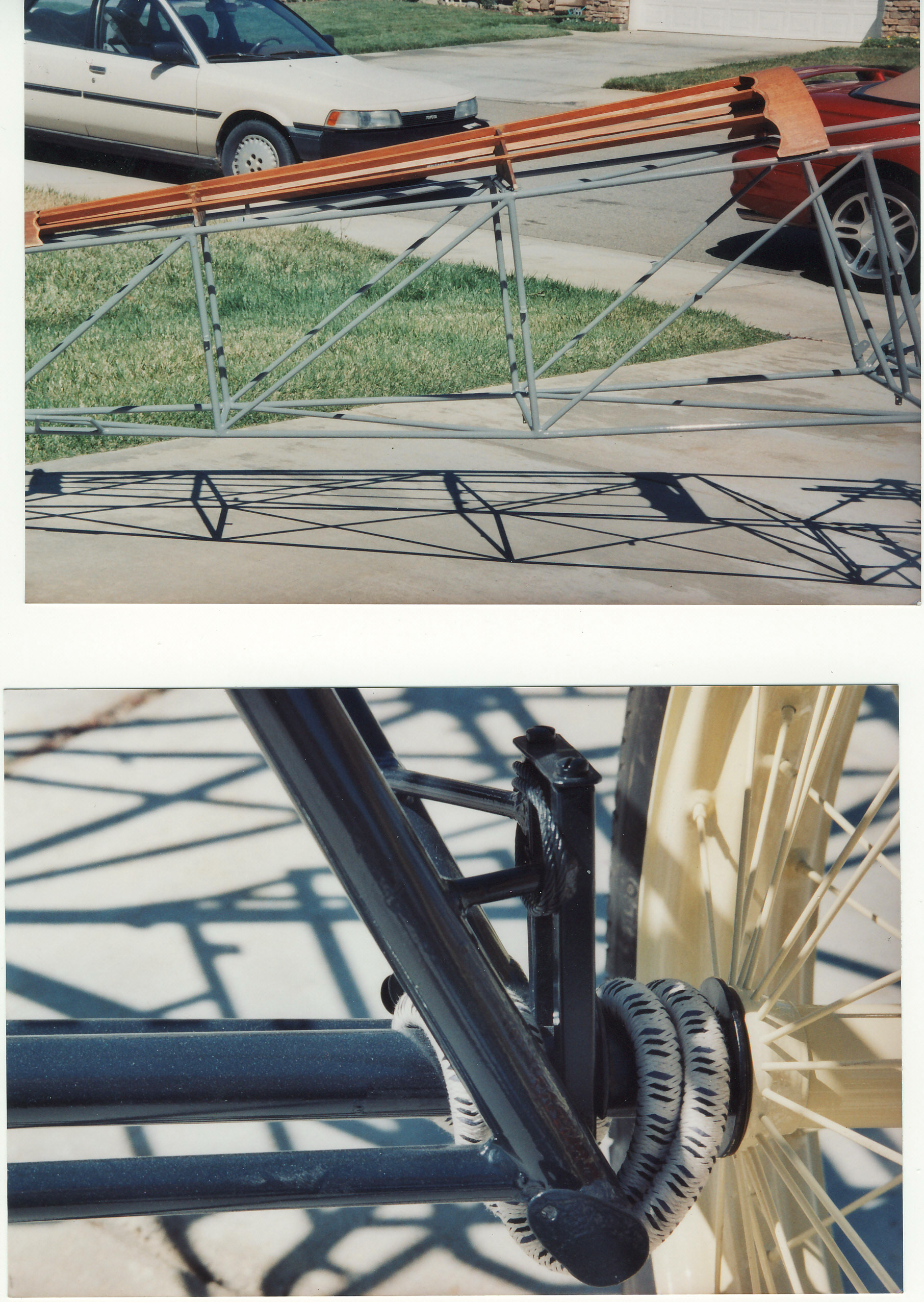

Message 7
| Subject: | Re: steel " jenny style" straight axle gear |
Hi Paul,
The gear on my plane is copied from a Thomas Morse Scout. It has a full floating
axle which means the axle is free to move from side to side and it can rotate.
It has rotated several times when a wheel runs dry on grease. I don't have
wheel bearings, just brass bushings in the wheels. If you are planning on
using brakes there is an easy solution to stop the axle from rotating. Just slip
a square piece of tubing over the axle and secure it to the axle. I guess
you could either weld or bolt it into place. I will attach some pics for you
to look at. I would need to go to the airport and measure the tubing since I
don't remember the dimensions. I won't be able to get out there for about a
week. Please keep in mind that the attached pics don't show the two sets of cross
wires.
Let me know what else you need so I can help you out.
Scott Liefeld
Flying N11MS since March 1972
Steel Tube
C-85-12
Wire Wheels
Brodhead in 1996
http://forums.matronics.com/viewtopic.php?p=407584#407584
