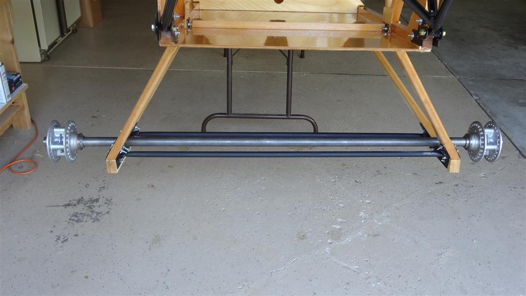

Another of what i consider to be milestones was getting my LG wheels onto the axle.
My friend Don Harper machined the 'cycle wheels for me and installed the
bronze bushings. The bushings went out-of-round when they were pressed so they
needed to be cleaned up with a brake cylinder hone. The axle is also not perfectly
round so it needed some polishing with some 400 grit paper. Now I can
have a shop cut the threads for the bolts, and the inner wheel retainers can
be welded in place. Also at long last the hubs and rims can take a trip to Buchanans
in California to get new spokes! I installed a tail wheel a couple of
weeks ago using Mike Cuy's drawings and Uncle Tony's book to install the leaf
spring style tail wheel from Matco. This girl will be on her own three feet
in a few more weeks!
Bob 'Early Builder' Dewenter
Dayton OH

Looks really clean Bob---nice going! That tail leaf spring setup worked
well for me in that you never have to get your hands into the fuselage to
put a socket
or wrench on the plate that sandwiches the Poplar triangle wedge because th
e bolts are welded to the 4130 plate.
Mike C.
