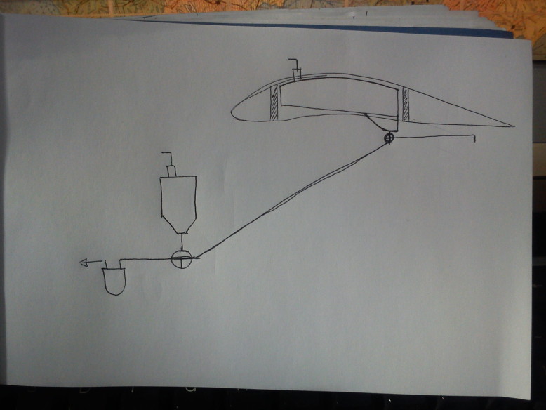

| Subject: | Re: About wing tank |
I thought about a little one in the nose, and how to use it.
One is fill the nose tank with the wing one, and connect the nose one to the gascolator;
this option need a vent from the nose tank to the wing one, isn't it?
the other option is a 3 way valve that connect the wing, nose and gas colator,
one position, wing gascolator, second position, nose gascolator. this one is simpler
because I avoid the vent from nose to wing. I think there is no trouble
with the second one if avoid conect nose with wing
Mario Giacummo

Message 8
Mario,
There's a third way to plumb the header tank, like mine is. You don't need to
vent the header tank to the wing if you have a vent on the header tank (at it's
own level) that you can shut off. That way the wing tank will fill the header
until it is full (when fuel runs out the valve), then you close it.
It's just like a big bubble in the fuel line on the way to the engine. Like an
hour worth of fuel big bubble (it could easily be as small as a gallon I think).
You just need to crack open that valve every so often to ensure the header tank
is full. It WILL be unless you've drained the wing tank pretty empty or there's
a problem. Just put the valve somewhere convenient so it's easy to do on
a preflight, not much different than sumping a tank.

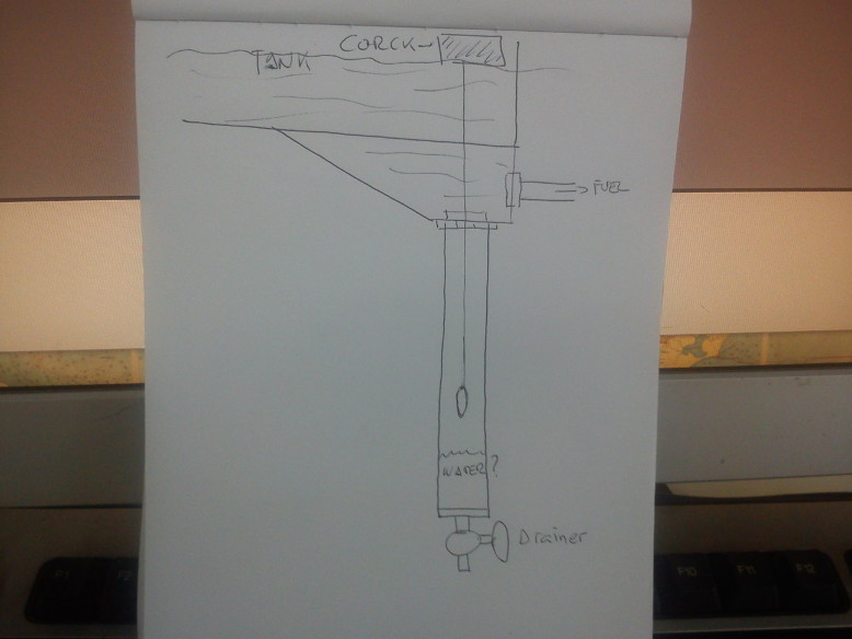

Message 10
Mario,
Also, I LIKE the drawing of your idea a lot. I didn't fully understand the little
dropped pickup point you did mention. If that were nearly a gallon or two,
it would really act like a header tank, especially if baffled well.
http://forums.matronics.com/viewtopic.php?p=408138#408138

2013/9/6 tools <n0kkj@yahoo.com>
> Mario,
> the little dropped pickup point you did mention. If that were nearly a
> gallon or two, it would really act like a header tank, especially if
> baffled well.

Mario,
Just some thoughts...
The majority of Pietenpols only have one tank, either in the wing or in the
fuselage...one fuel tank...one on/off valve. When the engine coughs at 500'
because you have been distracted during your flying and mismanaged your
fuel, the last thing you need is to try to remember which valves need to be
adjusted. If you have a flat-bottomed tank, the water will always be at the
trailing edge as the plane sits overnight, and during your pre-flight.
Whether you choose to have other fuel lines in the other corners is up to
you, just make sure that, from the fuel tank exit point, you have a
positive, downhill flow all the way to the gascolator, so that no water can
collect in any other part of the fuel system while sitting in the tail down
position. That way, at pre-flight, you can drain the fuel tank, and the
gascolator, and know that you have removed all the water.
Gary Boothe

Message 17
Understand, hands on, lets begin with the tank. but.... welded or
riveted?.. no, no.. it's a joke.
regards
Mario Giacummo
something like this?
Mario Giacummo
Photos here: http://goo.gl/wh7M4
Little Blog : http://vgmk1.blogspot.com
http://forums.matronics.com/viewtopic.php?p=408167#408167

Message 25
I've also got a sight gage like that and love it as well. Any water that winds
up in the wing tank is gonna show up there. Another feel good indication that's
hands free.
http://forums.matronics.com/viewtopic.php?p=408170#408170
Message 26
There's also valved port coming from the top of the header tank,
Tools: could you describe that "valved port" further? Pic or similar AS&A part.
Is it mounted on top of header tank? Thanks Paul
Paul Donahue
Started 8-3-12
http://forums.matronics.com/viewtopic.php?p=408180#408180

Hi Mario,
I agree that to get 12 gallons in a wing tank that isn't higher than the
standard airfoil will probably need a flat bottom.
With a flat bottom I would be concerned with having just one rear outlet,
even with a large sump. I would also suggest a rear drain and a front
drain, both with large sumps. I like a large sump that so that there will
always be a "head" of fuel by each drain, mine are made from half an old
Russian army canteen turned on it's side and holds almost half a quart and
is nicely streamlined. Sloping the tank bottom to one side isn't a bad idea
either and since most landings are turns to the left, I guess being on the
left side is a good idea.
Whatever you do, be sure the rear drain is the low spot in the three-point
position so any water in the tank will collect there and you can drain it.
Then when you drain your gascolator at the bottom of the whole system, you
should be safe from water problems.
A header tank can help as mentioned, but it does add some complexity and
some weight. A reliable, single wing tank of 12 gallons should certainly be
able to be designed without needing a header tank.
I went overboard and have three drains, which I admit is probably too much,
but it is hard to imagine a scenario where landing with low fuel will cause
a problem.
Douwe

Message 29
I'll be back with the plane next week... but...
It's a line coming out of the top of the tank, then goes down by the gascolator,
where there's a simple ball valve. If there's head pressure from the wing tank,
it will push any air or gas out the line and just down on the ground. You
could put the valve right on the tank, but when it over flows (when you manually
open the valve) it would get all over the place.
So, when I test it, I have to run enough gas out to account for the volume of fuel
in that little line from the tank to the valve, just a few ounces. If I see
a hesitation in the flow, I know I've purged some air from the top of the header
tank. In my case, the line coming out of the header is on the top, at the
front, where any air would be while it's sitting on the ground, tail low.
It's a very very simple system, with hardware store components. The ball valve
is actually a gas line valve, kinda hard to twist by hand. It's simple 1/4"
copper line plumbing.
http://forums.matronics.com/viewtopic.php?p=408183#408183
Message 30
About the weight. Dick determined 2RN was gonna be a bit tail heavy, so that was
also a consideration for a header tank, helped solve that problem. In the
event you do get into the header tank for fuel, it's a matter of I'd rather than
have fuel than optimal balance... which makes sense.
