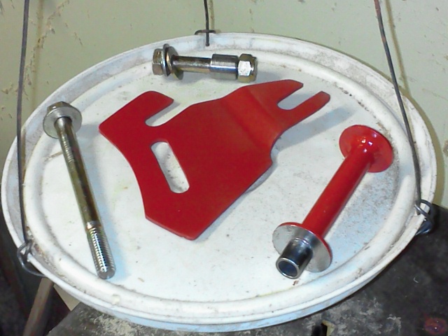

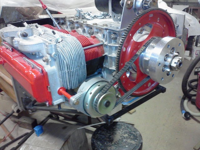

I have not posted for a while so I thought I would update with some pictures.
Using a corvair engine with a non standard starter meant a different location for
the alternator. Looked at a rear mount, even the new direct coupling to the
harmonic balancer but my engine is too close to the firewall. Settled on a
location low on the left side facing aft out of the cooling airstream. First
shows the the mounting hardware which weighs in at 7 oz. Next shows the location.
I am pretty happy with how it worked. Bracket is .080 4130 and has slotted
holes so it can be added to a Dan 5th bearing without removing the ring gear.
The spacer comes off of the lower bolt hole on the head and holds the other
end of the alternator.

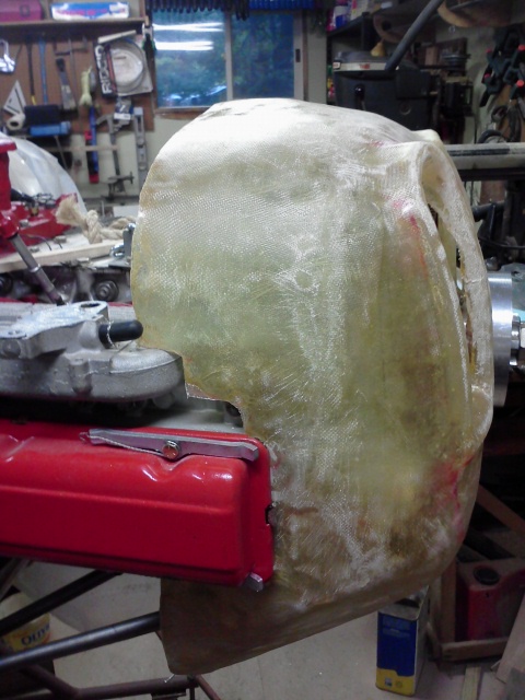

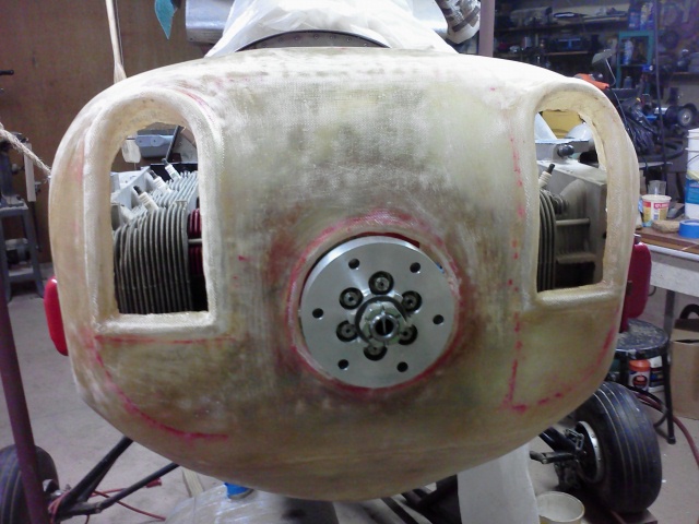

Message 10
| Subject: | GN-1 nose bowl for corvair |
I won a corvair nose bowl at the silent auction at Brodhead. It was cheap and
I think a reject but made a great mold. I needed extra room for my starter setup
and a little room for pulley clearance on the alternator. I had decided to
use a pressure cowl rather than eyebrows but I kind of like the eyebrow look.
I decided to incorporate that into the pressure cowl.
The pic. following is what I came up with. I managed to get it off of the mold
without destroying it or the mold and I am doing some finishing touches. It
is currently baking at 120 deg. to stiffen up the epoxy and then a final coat
of 2oz cloth and epoxy and it is ready to mount. last pic. shows the mold and
the other two show the nose bowl set in place. When finished I will split it
vertically so it will be easy to work from one side or the other to fit top cooling
baffles.
