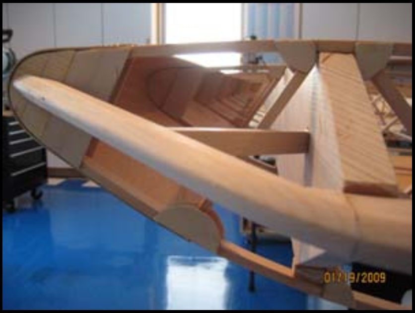

Joe,
I built my Piet using the British PFA/LAA approved plans from Jim Wills.
They include a fully enclosed leading edge using 1/16th ply.
There are some pictures on my web site (http://www.cpc-world.com). Look at
Page 9 under "Build Log" -> "Building Photographs".
I had some problems bending the ply around the ribs but eventually managed
to soak the ply over a small diameter pipe and used cargo straps to hold it
in place until the glue dries.
I had a ground loop soon after completion of the Piet and the wing hit a 5
inch fence post alongside the runway. The ply leading edge broke a little, I
had to replace one bay, but the fence post sheared out of the ground and was
left hanging on the fencing wires!
The Piet wing with a full ply leading edge is definitely strong!!!
Hope that helps.
Peter
Wonthaggi Australia
-----Original Message-----
[mailto:owner-pietenpol-list-server@matronics.com] On Behalf Of pringljo
Sent: Wednesday, 11 September 2013 11:50 PM
Subject: Pietenpol-List: Re: leading edge plywood
--> <joseph.pringle@gmail.com>
In looking at these pictures, I looks like most folks have used a solid,
rounded leading edge that runs the whole length of the wing, and then butted
the plywood up to it. However, in the picture Mike Perez posted, it looks
like he just used a rounded rib tip, and wrapped ply around that. How many
others have used that approach? Is this adequate?
Joe Pringle
Atlanta, GA
http://forums.matronics.com/viewtopic.php?p=408415#408415

I did a combo of Mike's and orig. Solid leading edge to start then large lightening
holes every 4 inches or so then wrapped ply around leading edge so also adheres
to 1/4 inch of bottom rib cap strip. I like the idea of tying in the top
and bottom of rib.
No nails or staples used through out with exception of temporarily stapling
leading edge with staples till dry.
Paul Donahue

One important distinction is that the leading edge of the Jim Wills wing has a
full wrap of 1/16" ply IN ADDITION to the solid leading edge. I have no doubt
that it would result in a very strong wing. The leading edge variation that
is being discussed is one that uses a full wrap of ply, but does not have the
solid leading edge beneath the plywood. The unknown quality of this variation
will be it's resistance to impact (hangar rash), since a single layer of 1/16"
ply likely will not tolerate much abuse. However, until the method has been
tried, this is all speculation. Photos of Peter's and Michael's leading edges
are attached, for comparison.
Bill C.
http://forums.matronics.com/viewtopic.php?p=408486#408486
http://forums.matronics.com//files/perezle_833.jpg
http://forums.matronics.com//files/img_0933_jpg_270.jpg

I encourage anyone to take a piece of 1/16" plywood used for LE purposes an
d secure it in a bend replicating a LE profile and whack it...with whatever
they choose.- This can possibly be done in a vise.- I believe you will
find that it is more than tough enough for the hangar environment.- To b
e as real world accurate as possible, you may choose do this after soaking,
pre-bending, mounting on a few mock ribs...=0A=0AMy method of making said
LE is to soak the plywood and bend it around a small diameter pipe/tube. (I
used about a 1" to 1-1/4" solid rod) Using refference lines and bending it
straight/square, let it dry on the rod.- When it is removed and relaxes,
it will fit nicely on the ribs.- Prior to soaking, you can bend the piec
es in your hands to determine in which orientation they bend the easiest. M
ake note to bend them this way once soaked and ready for bending on the rod
.=0A=0AThese pieces are epoxied directly to the rib noses and ribs. The ply
goes beyond the nose pieces and over the rib cap strips to tie the assembl
y together.- I believe my LE is about 10" wide, so I have 10" worth of ep
oxy, (T-88) on each rib, which equates to roughly 40" per LE panel.=0A=0AHa
ving this modification complete, assembled, covered and painted, I am confi
dent it it's strength and airworthiness.- But as noted many times in this
thread and other LE threads, it is untested and unproven.=0A=0A=0A=0A=0AIf
God is your co-pilot...switch seats.=0A=0A=0AMichael Perez=0APietenpol HIN
T Videos=0AKaretaker Aero=0Awww.karetakeraero.com
