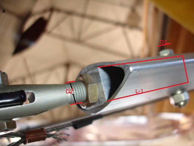

Hello folks, to vary a question about the subject.
I am going to use round tubes for the wing struts, of course I search and read
everything I can, the replace option for the streaming ones used in the Piet are
round tube with OD = 1 3/4" and 1.2 mm wall thikness (I do not remember where
I found this). now the question is other, I was looking the photo attached
here and I plan to do something like that, but something is not very clear, as
I see in the strut is an .. aluminium? block, and a bolt holding it.. just one
bolt?. .. of what diameter? A4 or A5?... the other question is how long is the
inside piece? is this piece threaded?.. and the diameter of the D2 bolt ? (i
do not know how to name it)..
Thank you in advance
Mario Giacummo
Photos here: http://goo.gl/wh7M4
Little Blog : http://vgmk1.blogspot.com
http://forums.matronics.com/viewtopic.php?p=408783#408783

| Subject: | Re: round tube wing struts |
Mario,
I hope this helps. You might have to fix the links if they were broken onto multiple
lines.
I beleive what you are looking at is from Don Helsper. D2 is a J-3 cub WING STRUT
ADJUSTMENT FORK
FAA/PMA'd. J-3 & PA-11. Replacement for 13770-00. Includes bolt, nut, cotter pin
& jam nut. Measures 5/16" bolt hole. Measures 7/16" x 20 thread NF3.
It can be seen here
http://www.aircraftspruce.com/catalog/appages/strutadjfbsets1.php?clickkey=394462
The insert in the aluminum strut is a part from McMaster carr. It is either 7075
or 6061 aluminum stock that is flat on each side
This next paragraph is a post on this forum from dan Helsper and explains the insert.
quote...
Larry Williams has been flying his airplane with the aluminum Skytech struts for
years now. These are the same ones I put on my airplane. Advantage is less weight.
If you don't want to attempt welding these (which I didn't) you have to
insert and attach the end fittings with AN bolts. I used 7075 aluminum rectangular
bar stock for the end fittings McMaster Carr Supply # 9055K13 $48.38 for
3 lineal feet. Worked great.
Dan Helsper
Poplar Grove, IL.
Bob 'Early Builder' Dewenter
Dayton OH
http://forums.matronics.com/viewtopic.php?p=408786#408786
Mario,
I assume you are talking about using chro-moly steel (4130) round tube, and not aluminum tube. The streamline tubing in the photo is an extruded aluminum shape. It is not recommended to weld aluminum that is to be used as a structural member, as it can significantly weaken the metal in the weld zone. That is the reason why there is an aluminum block inside, secured with bolts. When using steel, you have the advantage of being able to weld without compromising the strength of the tube. For the inner threaded part, you can purchase wing strut barrels http://www.aircraftspruce.com/catalog/appages/strutadjfbsets3.php?clickkey=3621
(Aircraft Spruce part no 05-05900), which can be welded into the ends of your steel
tube struts.
One point to consider, when using round tubes for your struts is that they will
create a lot of drag. Round struts really are not aerodynamically "clean".
You should give serious thought about adding some kind of fairings to streamline
the tubes.
Hope that helps.
Bill C.
http://forums.matronics.com/viewtopic.php?p=408807#408807

2013/9/18 Bill Church <billspiet@sympatico.ca>
> Mario,
> your steel tube struts.
> will create a lot of drag. Round struts really are not aerodynamically
> "clean". You should give serious thought about adding some kind of
> fairings to streamline the tubes.
> Hope that helps.
> Bill C.
