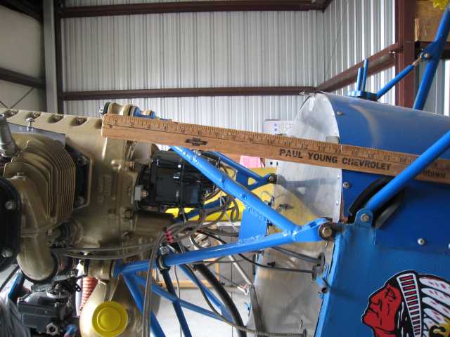

One more data point for you: the mount that is on my Air Camper, "Scout". I have
an A75 but it's pretty much identical in weight to the A65. The attached picture
doesn't show this clearly, but the nose of the ruler is right at the plane
where the engine mount meets the rear of the engine. As you can see, my mount
is about 14-1/2" long (14" from center of engine mount bolts). My airplane
balances nicely with the cabanes swept back; I believe it's 4" of aft tilt.
Empty weight is 636 lbs., with 307 on the left main, 304 on the right main,
and 25 on the tailwheel (all in the level attitude).
