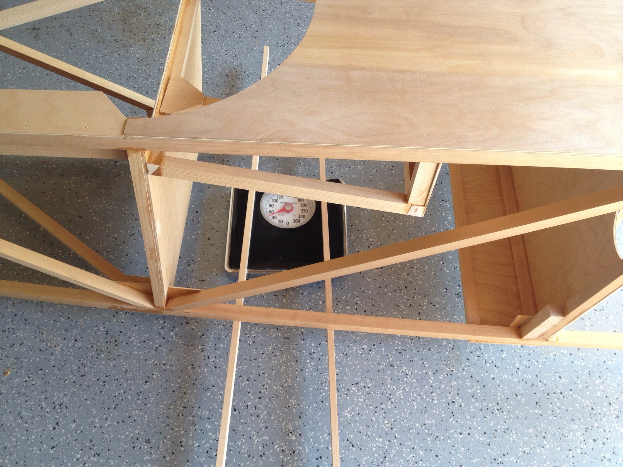

I happened to weigh my wood long fuselage with seats and floor plywood. It weighs
exactly 50 pounds. Once you get those installed you will have something to
compare. I see a lot of weight savings by not having the plywood on the sides.
2'x8' 1/8 ply weighs about 10 lbs times two sides. I plan on compensating for
that with more horsepower, diet and exercise.
Seats weren't finished in the picture but the parts were placed on top fir the
weighing. The are to be installed later.
Sorry about the picture size.
