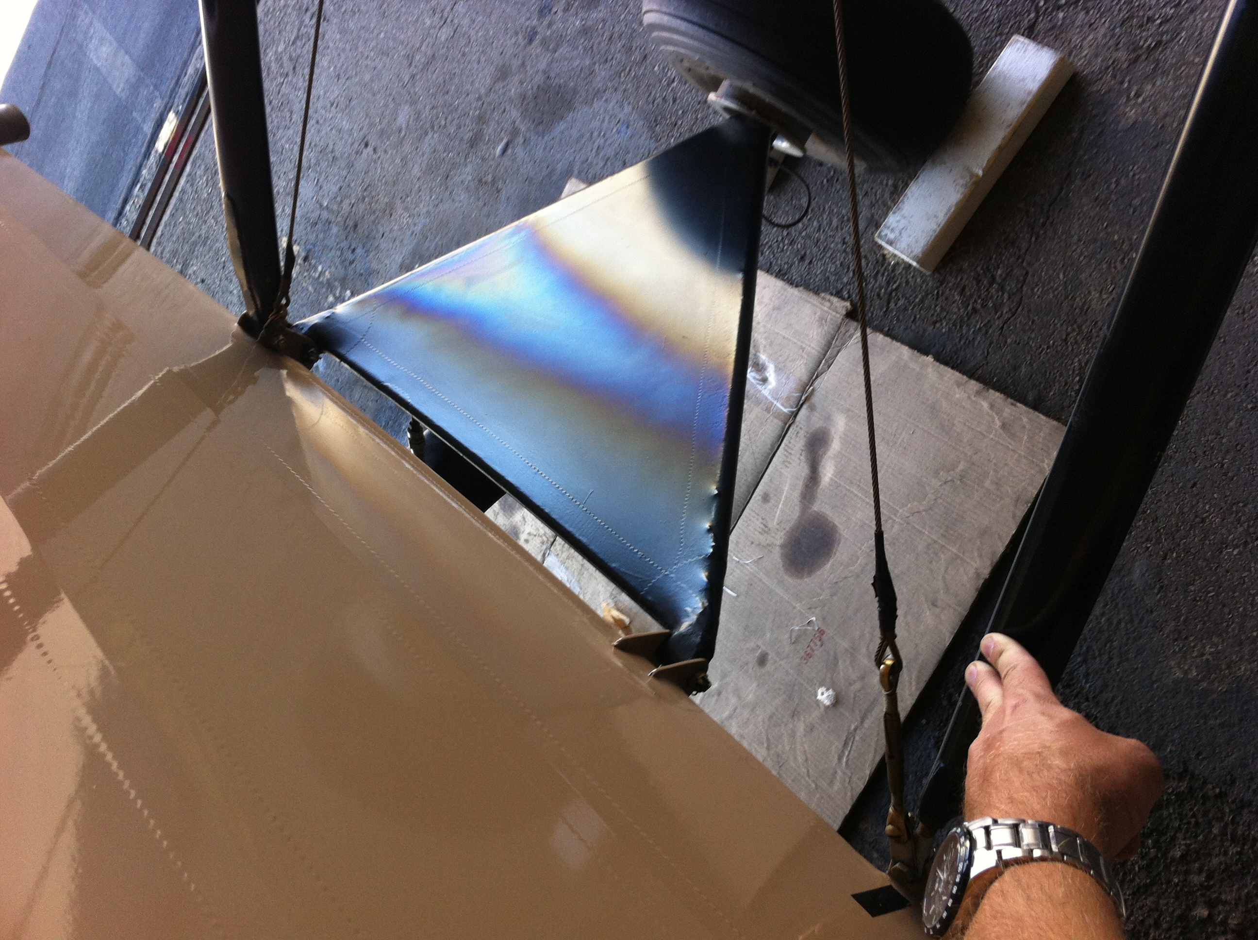

I've noticed lately that the right gear attracts soot or exhaust dust after flights.
I've noticed this over the previous 10hrs. It does wipe off easily. I am
concerned about exhaust heat on leading edge of said gear fabric. I put my hand
on the rear strut inflight (as pictured), and it feels about like 80 degrees
in the wake.
The exhaust/engine/landing gear is standard J3 Cub. Perhaps someone with a Cub,
or similarly configured GN-1 could shed some light on it. Is this a real concern?
Maybe I could just ad a metal shroud on leading edge of gear fabrique..
Lerrr

I wouldn't worry about it at all. In fact the fabric on the belly of the plane
probably sees more heat. Mt landing gear paint is discolored from exhaust heat
(not soot). Think of it this way. Fabric planes sit outside in the 110degree
desert for years without fabric issues. If you have some soot on the gear
legs then I would guess that your engine may be idling a little rich or you are
taxing back to the hangar with the carb heat on. The carb heat makes the engine
run rich.
My 3 cents, Don't worry about it.

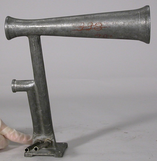

Chuck,
I have been flying 32 years and had never heard of it either, but here ya go-
http://airandspace.si.edu/collections/artifact.cfm?id=A19570800000
Semper Fi,
Terry Hand
Athens, GA

I agree with Scott. Besides, your exhaust looks to be about the same
distance from the gear strut as it is on a J-3 and they don't seem to have
issues with it.

What concerns me, is that it used to not be there. I wonder what causes it to be
there w/in last 10 hrs. Maybe the next sortie.. I may tape a thermometer onto
leading edge of gear leg and see what it reads.
oil temp in flight seems steady at 165 deg during 3+ hrs flying yesterday...oil
pressure, nominal, etc.. so I don't think anything is happening internally on
the A65. I suppose I could just make peace with the idea that I could always
abandon the machine inflight if it ever decides to catch fire...no biggie
KLNC
A65-8
N2308C
AN Hardware
Airframe 724TT
W72CK-42 Sensenich
Standard Factory GN-1
http://forums.matronics.com/viewtopic.php?p=409370#409370

Maybe it is just a light oil film from the breather. The cont. engines will push
out extra oil if you run them at the full mark. I usually run mine between
3 and 3.5 quarts to keep the mess to a minimum.
Oh, if your plane is covered with the Stitts / Poly Fiber it will not burn. Let
me rephrase that. It will burn if you hold a flame to it. When you take the
flame away it stops burning. If it is covered with dope, it could burn.
Food for thought.
Scott Liefeld
Flying N11MS since March 1972
Steel Tube
C-85-12
Wire Wheels
Brodhead in 1996
http://forums.matronics.com/viewtopic.php?p=409375#409375

On Sep 27, 2013, at 4:50 PM, "AircamperN11MS" <Scott.liefeld@lacity.org> wrote:
push out extra oil if you run them at the full mark. I usually run mine between
Let me rephrase that. It will burn if you hold a flame to it. When you take
the flame away it stops burning. If it is covered with dope, it could burn.
> Food for thought.
> Scott Liefeld

Hi.
After a forced landing from climb out with A75 up front the Air Accident
Team included this graphic in the report of the case.
In essence their report and all other information they had on file
indicated carb ice could build in just about any sort of combination of
temperature, humidity and flight sector.
In my case after copious use of Carb Heat prior to take off and a full
power climb out I thought I would be immune but no.
A 500 foot take off at full power run over wet grass strip was perfect
for carb icing.
Take a look at your Carb heat setup and ensure it does what it's meant
to do.
Gerry
