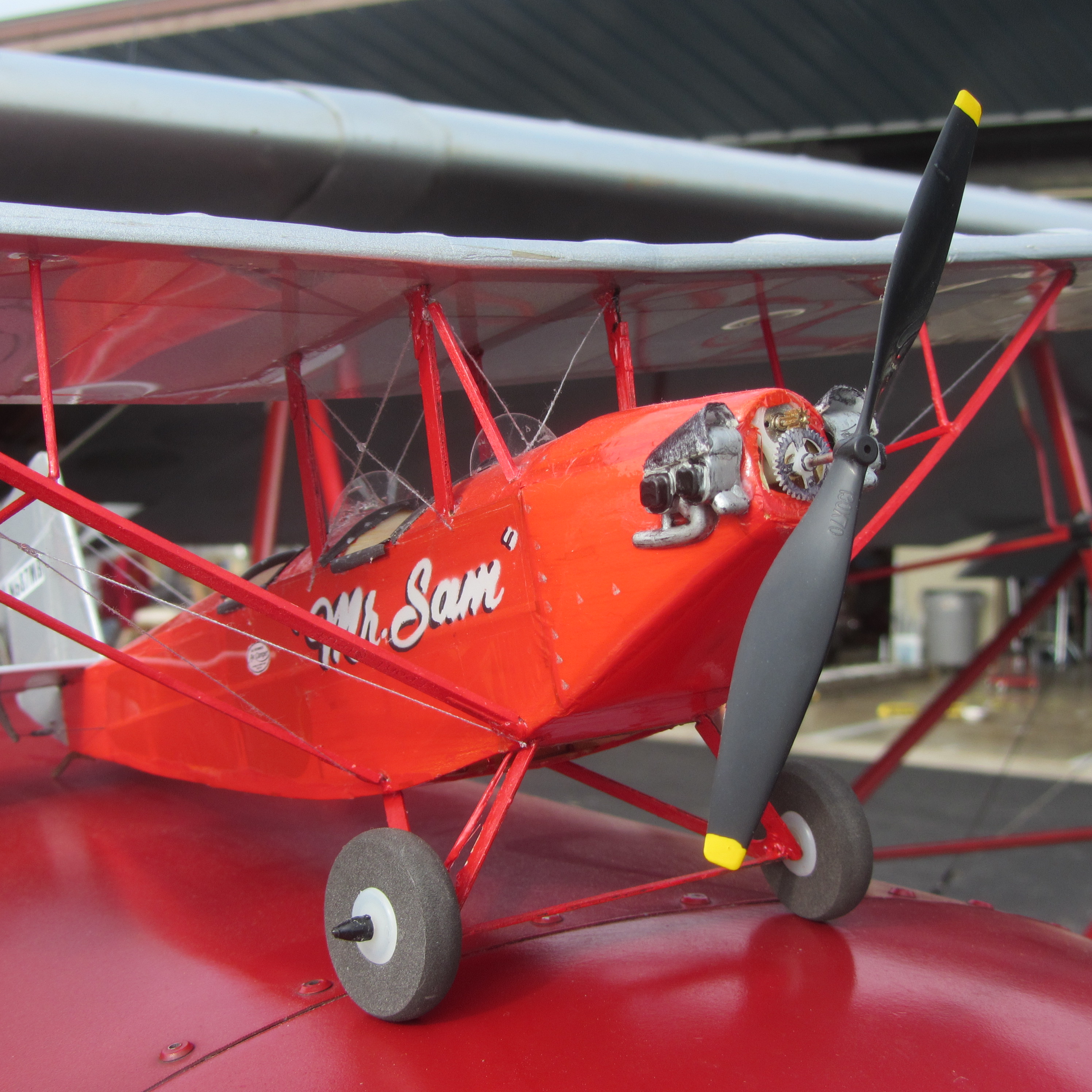

      Since you are building an RC version of your Piet - I thought you might get a kick
      out of my RC Piet.  The RC Piet is from Stevens Aero and was built by Paul
      Stamison.  Mr. Jin Woo provided the decals.  The front and rear cockpit instruments
      in the model match the ones in my Piet
      Jim McWhorter

      Jim;
      I see a real problem with your scale model of Mr. Sam.  It needs a free-castoring
      tailwheel ;o)
