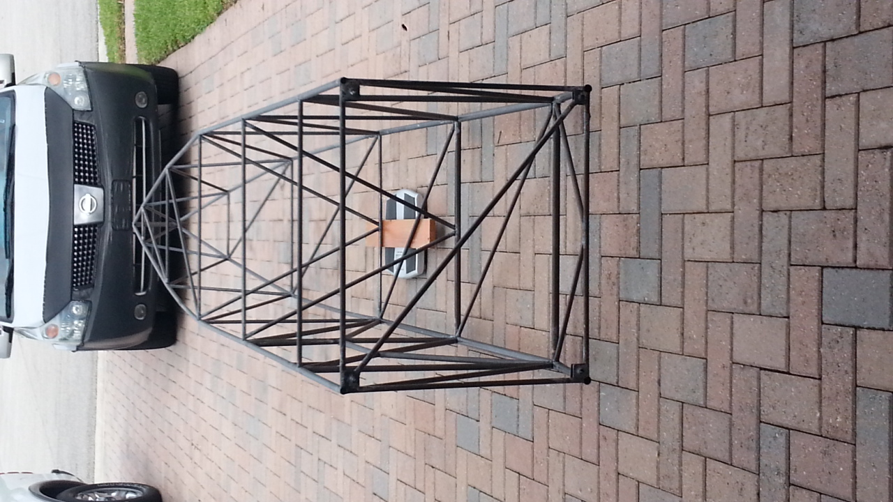

Update: tacked two sets of "V" bracing behind each seat and welded the receiver
fittings that my mount will bolt on to. Still have small piece of longeron to
cut out eventually for the door and no seats yet, but weighs in at 34.5 lbs.
Cant imagine over 40 lbs after seats.

Paul; it's looking nice. Do you plan to bead-blast and powder coat it after you
get all the fittings and tabs installed, or will you just go with primer and/or
paint? I don't know about powder coating but it seems to me that if you need
to add a tab or fitting after you've powder-coated, you won't be able to get
the same finish on the added parts that you have on the powder-coated rest
of the thing.
