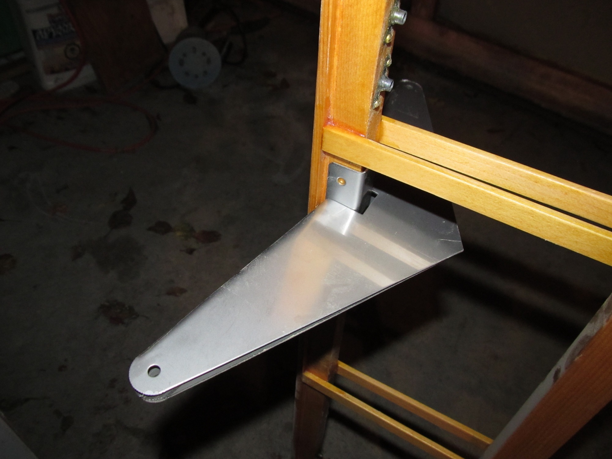

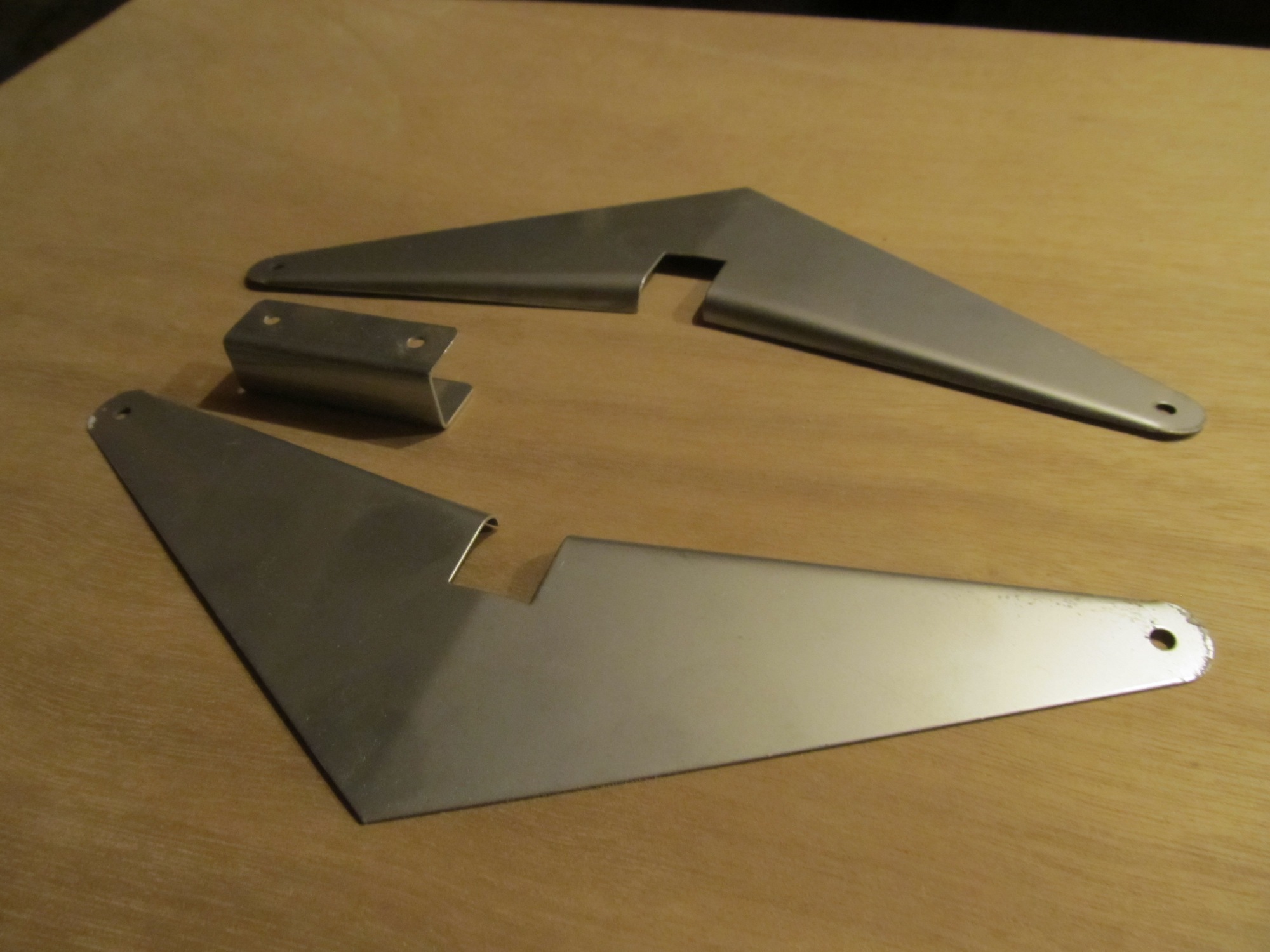

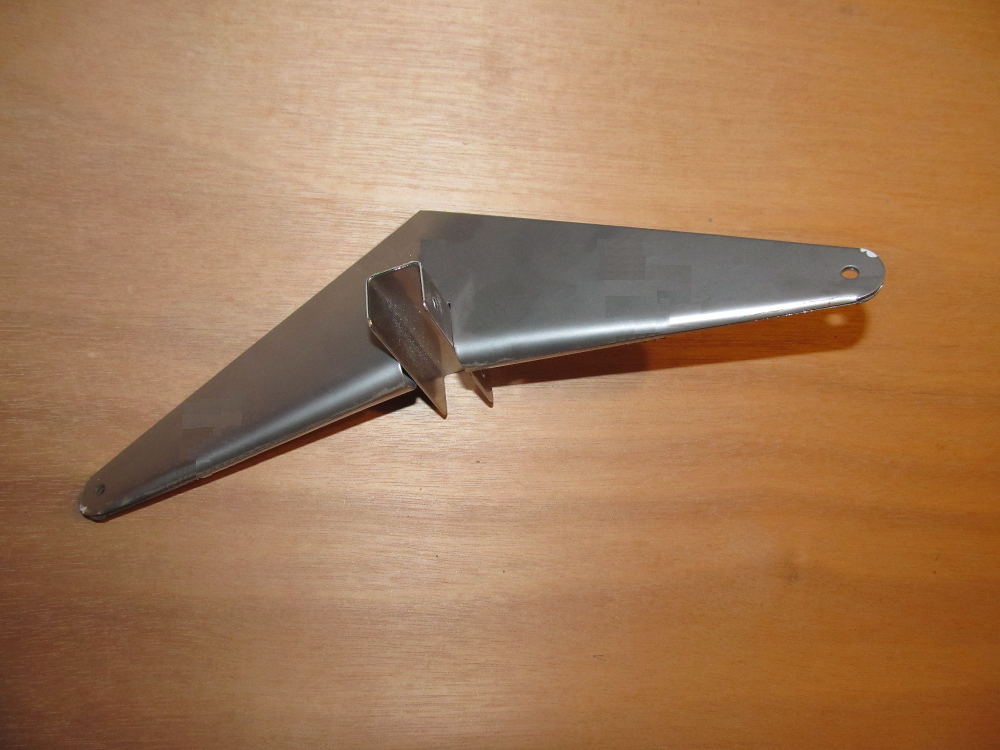

      >>The advantage of this method (aside from being easier to fabricate) is
      that the channel can be >>made to actually fit the wood that it attaches
      to.
      True, but what I did was made the wood fit the channel by gluing some extra
      1/16" ply and sand to fit.
      Nice work on your control horns btw.
      rh
      On Wed, Oct 23, 2013 at 1:09 PM, <gcardinal@comcast.net> wrote:
      > This is exactly how the elevator and rudder horns on NX18235 were built.
      > It is a worthwhile change from the plans.
      > And for those of you who haven't decided whether to use the formed control
      > horns or flat sheet, read Bill Church's last paragraph regarding
      > aesthetics, weight, strength and build difficulty.
      > Bill is correct on all counts.
      > Greg Cardinal
      > *From: *"Bill Church" <billspiet@sympatico.ca>
      > *To: *pietenpol-list@matronics.com
      > *Sent: *Wednesday, October 23, 2013 8:33:32 AM
      > *Subject: *Pietenpol-List: Re: A Simple Cut - But My Simple Mind Needs
      > Help
      > One other option for the "tabs" on the formed control horns is to make
      > them from three pieces of metal, as opposed to two.  Rather than bending
      > the side tabs, a separate channel can be bent, and welded on.  The
      > advantage of this method (aside from being easier to fabricate) is that the
      > channel can be made to actually fit the wood that it attaches to.  If the
      > horns are made "to the plans", the gap between the bent flanges will be
      > wider than the profile of the wood where it attaches (see photo of control
      > horn in position for clarification).  Unfortunately, I haven't welded my
      > horns yet, so I can't provide photos of the finished product, so I have
      > just positioned them in place for these photos.
      > In my opinion, the formed sheet metal control horns are aesthetically much
      > more appealing than flat steel horns (especially on a vintage aircraft like
      > the Pietenpol), and, as long as they are properly welded and treated, are a
      > superior design.  The slight bends in the sheet metal produce a much
      > stiffer horn than any solid horn of similar weight.  Increasing the
      > thickness to .09" increases the overall weight of each horn by 50%.  And,
      > to top it all off, the formed horns really are not difficult to build.
      >  Honestly.
      > Bill C.
      > http://forums.matronics.com/viewtopic.php?p=411183#411183
      > http://forums.matronics.com//files/img_5414_166.jpg
      > http://forums.matronics.com//files/img_5424_821.jpg
      > http://forums.matronics.com//files/img_5425_120.jpg
