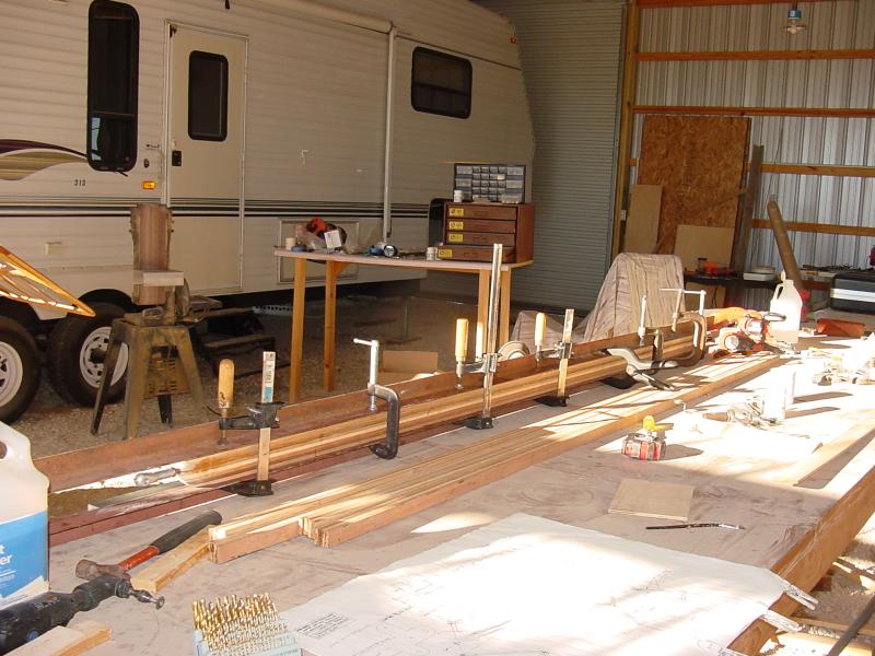

Well Ray after much searching I found some pictures. Maybe they will bring forth
a better understanding.
Oscar the wood coaming is very tough. My physical condition makes it hard to get
in the Piet so I made it kind of bullet proof. I can step almost anywhere getting
in and out without damage. The red oak can be refinished if need be.
Jerry Dotson

Message 6
| Subject: | Re: SERFI FLY-IN |
Jerry,
OK, now I understand! The rod goes down the center of the strut, very intelligent
of you! That has all the benefits of wood AND metal struts. Any idea on the
weight of your struts?
Thanks for the effort to find the photos and sharing them. I am always I pressed
with this groups' innovation and willingness to share.
Ray Krause
