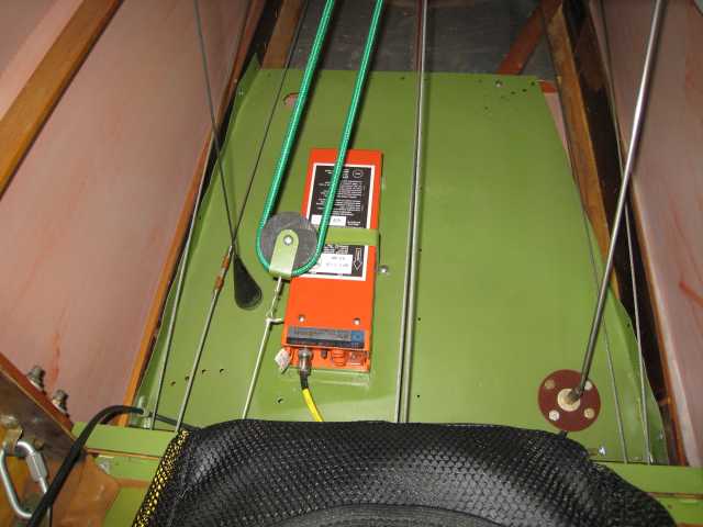

Ray,
Yes, that is how the wires connect. I think you must be seeing the elevator
connecting rod as the antenna. The antenna is vertical against the fuze
side. I wanted the antenna vertical and put the ground planes where they
would fit. Yes, the 23" length works well for the middle of the com
frequencies.
I bought the plane with 2 non impulse Bendix(lunchbox) mags. I got the
Eisemann on ebay, so it would be safer to hand prop, and a guy on the field
gave me the shielded harness, he had an incomplete set of 7 and I only
needed 4. They aren't really made to fit the Eisemann, I got some of those
auto type rubber booties and just stuck the leads in the Eisemann and they
have been good for about 200 hours now. Yes, I am running the same standard
aircraft shielded plugs that came with the plane, used with the Bendix mags.
Skip

> Skip,
> Yes, I have conformed to the AD, no problem with the coils on the mags.
Do you also run shielded plugs? Where did you get the shielded harness,
make it? And if so, how did you make it?
> On the antenna: the coax cable central wire connects to the antenna which
is 23" long, and the ground wire connects to each of the 23" ground pieces?
The ground pieces are then attached to the fuselage sides vertically and
the antenna is held horizontally, or parallel to the longerons? And these
measurements work well for communications frequencies?
> Thanks, this really helps, just what I needed for the antenna.
> Looking forward to your response. Way too many questions?!
> Thanks,
> Ray Krause

Attached is a photo of the setup that I have in Scout. Corky used a piece of shop
scrap aluminum to form the ground plane, and the ELT antenna and VHF COM antenna
share the ground plane. The ELT is also mounted to the aluminum, since
it is nicely accessible for inspection and service behind the seat in that location
and it is pretty likely to survive a crash there as well. A short piece
of coax leads from the COM antenna (a standard aircraft bent stainless steel
whip) to a bulkhead fitting right above the pilot's right shoulder, where a short
coax lead can be connected to a handheld when it's in use. The rest of the
time there are no wires visible in the cockpit and the bulkhead fitting has
a screw cap to cover it. The black thing at the bottom of the photo is a small
pouch that is attached to the back of the hinged rear seatback/access panel.
Yes, I know that there are aircraft cables in close proximity to the ELT and COM
antennas and that they mess up the nice radiation patterns. Yes, I know that
the ground plane is dimensioned less than ideally for optimum antenna efficiency.
Yes, I know that the antennae are too close to each other and neither is
optimally placed on the ground plane. Yes, I know that there are signal losses
through the additional BNC connectors and coax. I can live with that.
