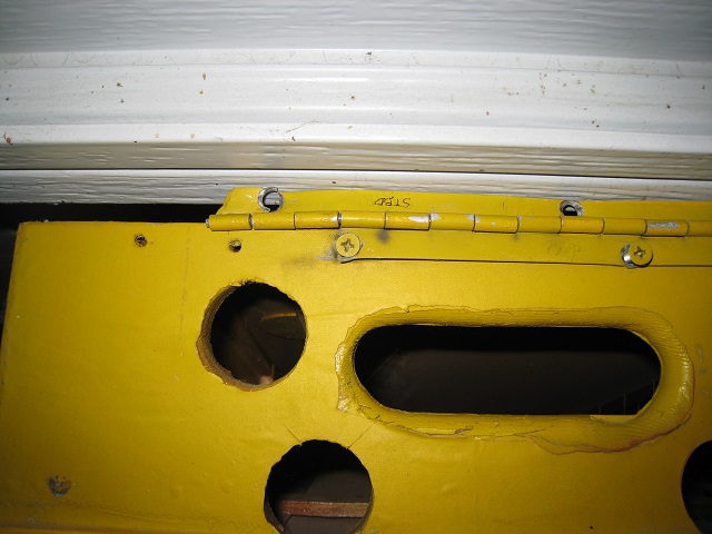

      Terry; the hinge straps on my flop are 3/4" wide.  Now, take a look at the attached
      picture of the hinges that I replaced and note a few things NOT to do.  (1)
      don't countersink the screws... there is no need to, and it really weakens
      the material; (2) keep the holes away from the edge, because as I and others have
      noted, the flop can flop and when it does, the metal gets stressed at the
      screw holes.

      Alright, you made me do it. My flop. The open
      areas will be covered both sides with lexan.
      And yes, I've sat a piece of it in a bottle of
      fuel for days with absolutely no effect.
