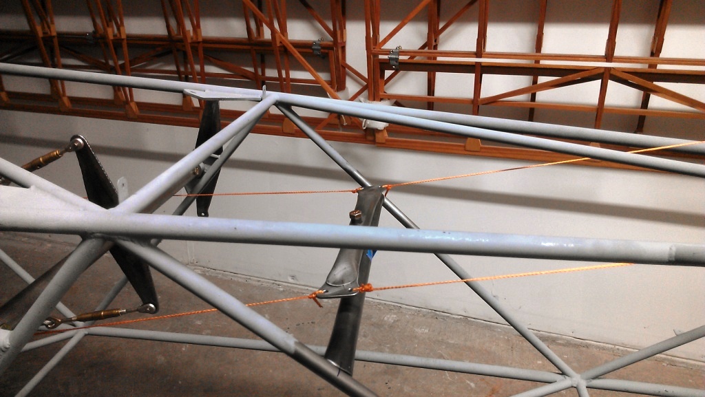

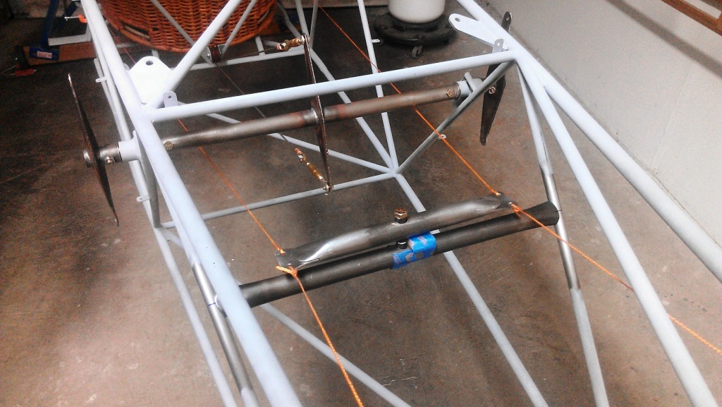

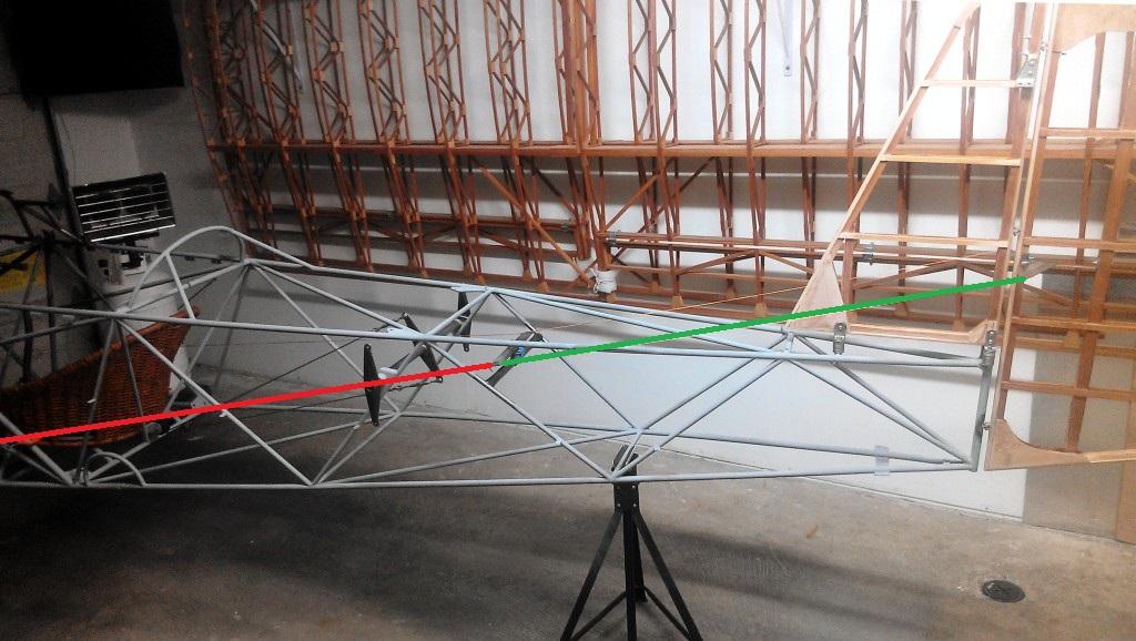

Hello good Piet-ple,
Hope everyone had a great Thanksgiving holiday...!
The break gave me a chance to make progress on my rudder cable routing.
I am using rudder pedals (with toe brakes) instead of a rudder bar so there may
be times when I inadvertently press on BOTH pedals at once - such as a situation
of hard braking. With a rudder bar, pressing with both feet at once would
not cause a significant increase in tension on the rudder cables (or the rudder
hinges), yet with pedals I needed to do something to address this issue.
My solution was to fabricate a rudder cable "pivot bar" in the aft fuselage that
is designed to take the loads if I press on both pedals at once. This design
should also allow the cables from the pivot bar aft to the rudder horn be maintained
at a constant tension. This is the simplest modification I could think
of while still keeping with the intent of Bernard's original design.
In the photos you can see orange string strung (fun to say that) where the cables
will be. I superimposed a RED line where the cable runs from the pedal to the
pivot bar, and a GREEN line from the pivot bar aft to the rudder horn.
As with all of these modifications i ma making to the design, a caveat is that
I have not yet completed or flown my plane so everything is subject to change(!)
I drop the parts off to the welder in a few hours... funnn stufff

An elegant solution, Jake! I don't believe I've seen this setup on another Piet
before. Have you thought about rudder stops, and will those be at the pedals
somewhere (either cockpit)? I ask this because I very recently fabricated new
stops for my rudder bar, under the front seat.

I just love the smell of steel tube in the morning. Yes I really mean it. It
looks good Jake.

Yes I am thinking about rudder stops. I have some thoughts about adding a part
to the pivot bar but I want to get it all welded up and working before I do anything
rash....! (one step at a thyme...!)
