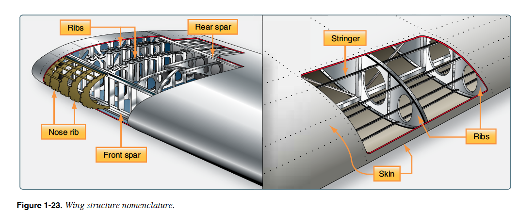

Message 10
| Subject: | Rib Support Pieces |
I might be able to check the archives if I knew the proper name for these longitudinal
rib supports. Some have them and some dont. I dont see them in the plans
and was wondering if they are necessary?
John Francis
http://forums.matronics.com/viewtopic.php?p=415161#415161
http://forums.matronics.com//files/img_0917_182.jpg
Message 11
| Subject: | Re: Rib Support Pieces |
John,
I think they are typically referred to as, simply, verticals.
But I did not check the archives either. [Wink]
Semper Fi,
Terry Hand
Athens, GA
http://forums.matronics.com/viewtopic.php?p=415167#415167
Message 12
Stringers, I bellieve is the correct term, although, someone please chime in if
I am incorrect.
The attached screenshot is from page 1-13 of the Handbook linked below-
http://www.faa.gov/regulations_policies/handbooks_manuals/aircraft/amt_airframe_handbook/media/ama_ch01.pdf
Semper Fi,
Terry Hand
Athens, GA
http://forums.matronics.com/viewtopic.php?p=415168#415168

I believe someone on this list posted that rather than fiddle with wood pieces
for 'stringers', they used some of that fiberglass-reinforced plastic strapping
tape that cardboard boxes are sometimes banded with. Not the sticky tape that
comes on a roll... the stiff white or black stuff. Weighs next to nothing
and you could probably tow a car with it.
I'm just not sure it's necessary to use those stringers, since the ribs are all
laced to the fabric. The ribs don't have the ability to shift or deflect once
they are laced in place.
