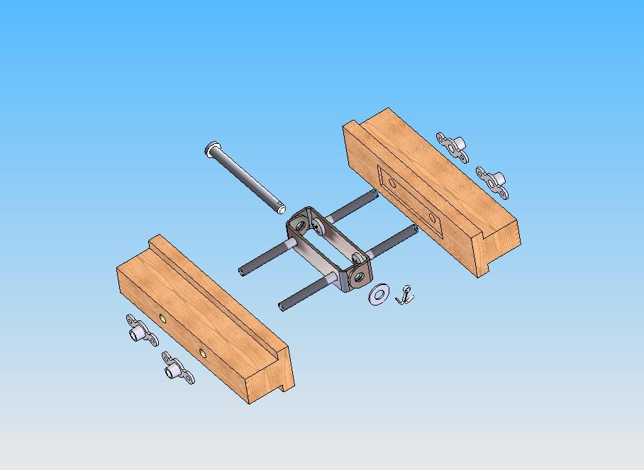

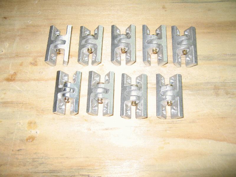

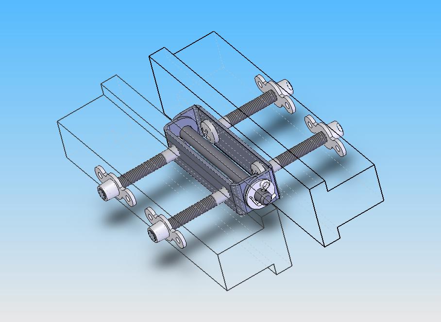

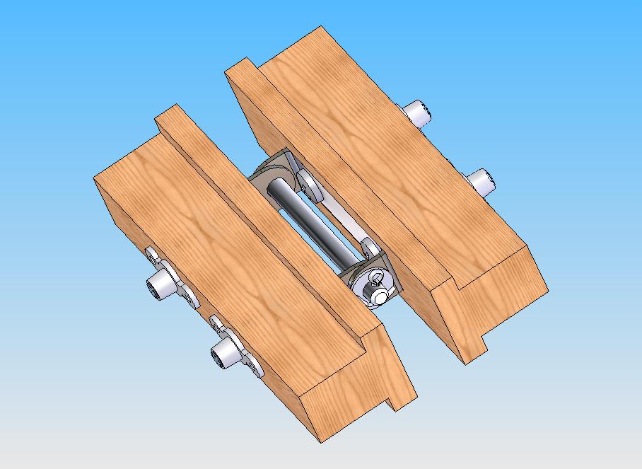

| Subject: | Re: Rudder and Elevator Hinges |
The "U-channel" hinges mentioned by Terry and Skip are much easier to fabricate
than the plans version. There's no welding required, and they're easier to install,
since they're not so tiny and fiddly (that's a technical term). When
I made mine, I had borrowed the idea from Jim Markle, who had borrowed it from
the Fly Baby design. The original Fly Baby design is quite a bit larger, and
results in a noticeable gap. I made mine smaller, and tried to minimize the
gap. Mine are 1/2" wide, and a little under 2" long (1 15/16" to be precise)-
designed to utilize a MS20392-2C-65 clevis pin (3/16" diameter, 2 1/32" effective
length). I fabricated mine from 16ga (.06") stainless steel, which I had
on hand, but 4130 would work just as well. They could even be made from thinner
material (18ga). Attached are a few images.
Bill C.
http://forums.matronics.com/viewtopic.php?p=415186#415186
http://forums.matronics.com//files/my_hinge_assembly_1_186.jpg
http://forums.matronics.com//files/my_hinge_assembly_explode_104.jpg
http://forums.matronics.com//files/my_hinge_assembly_metal_parts_501.jpg

>=0A> When I was at Corvair College in Barnwell SC last month I spent a gre
at=0Adeal of time going over P.F. Beck and Don Harper's Pietenpols. Don use
d to=0Amake and sell hinges similar to Vi Kapler's design. I asked him if h
e still=0Amade them but he said no as he no longer had access to a machine
shop. =0A>=0A> He did, however, suggest an alternative that just about any
one could=0Amake. I have included a very rough drawing I made of his idea.
No laughing=0Aat my artwork, Douwe.=0A>=0A> Your thoughts?=0A>=0A> --------
=0A> Semper Fi,=0A>=0A> Terry Hand=0A> Athens, GA=0A>=0A>=0A> Read this top
ic online here:=0A>=0A> http://forums.matronics.com/viewtopic.php?p=41513
1#415131=0A>=0A>=0A> Attachments: =0A>=0A> http://forums.matronics.com//fil
es/image_798.jpg=0A>=0A>=0A=0A=0A________________________________- Messag
e 8- _____________________________________=0A=0A=0ATime: 12:36:30 PM PST
US=0AFrom: "skipgadd@earthlink.net" <skipgadd@earthlink.net>=0ASubject: RE:
Pietenpol-List: Re: Rudder and Elevator Hinges=0A=0A=0AThey are sold.=0ASk
ip=0A=0A=0A> [Original Message]=0A> From: skipgadd@earthlink.net <skipgadd@
earthlink.net>=0A> To: <pietenpol-list@matronics.com>=0A> Date: 12/8/2013 2
:34:49 PM=0A> Subject: RE: Pietenpol-List: Re: Rudder and Elevator Hinges
=0A>=0A<skipgadd@earthlink.net>=0A>=0A> I have a set of hinges similar to D
on's alternative design. Mine are .063=0A> 4130 and 1/2", otherwise the sam
e, made by my friend Gary Barger. I think=0A> we got the plan from a guru a
t Brodhead years ago. I got a set of Don's=0A> aluminum hinges so I don't n
eed these. They are already in primer.=0A> $25. post paid to cont US. Write
me off list.=0A> Skip=0A>=0A>=0A> > [Original Message]=0A> > From: jarhead
pilot82 <jarheadpilot82@hotmail.com>=0A> > To: <pietenpol-list@matronics.co
m>=0A> > Date: 12/8/2013 1:33:03 PM=0A> > Subject: Pietenpol-List: Re: Rudd
er and Elevator Hinges=0A> >=0A> <jarheadpilot82@hotmail.com>=0A> >=0A> > W
hen I was at Corvair College in Barnwell SC last month I spent a great=0A>
deal of time going over P.F. Beck and Don Harper's Pietenpols. Don used to
=0A> make and sell hinges similar to Vi Kapler's design. I asked him if he
=0Astill=0A> made them but he said no as he no longer had access to a machi
ne shop. =0A> >=0A> > He did, however, suggest an alternative that just abo
ut any one could=0A> make. I have included a very rough drawing I made of h
is idea. No laughing=0A> at my artwork, Douwe.=0A> >=0A> > Your thoughts?
=0A> >=0A> > --------=0A> > Semper Fi,=0A> >=0A> > Terry Hand=0A> > Athens,
GA=0A> >=0A> >=0A> >=0A> >=0A> > Read this topic online here:=0A> >=0A> >
http://forums.matronics.com/viewtopic.php?p=415131#415131=0A> >=0A> >=0A>
>=0A> >=0A> > Attachments: =0A> >=0A> > http://forums.matronics.com//files
/image_798.jpg=0A> >=0A> >=0A> >=0A> >=0A> >=0A> >=0A>=0A>=0A=0A=0A________
