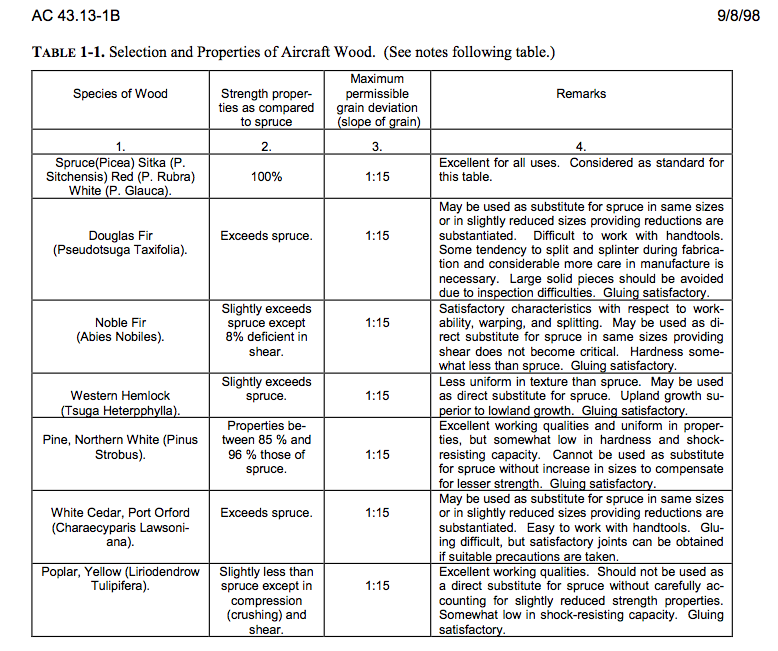

      I have finished both sides of my fuselage,  it appears I may run short of Spruce
      for the horizontal cross pieces.  I was thinking of using my remaining spruce
      from the tail forward, then if needed substitute either good fir or poplar.
      Couldn't find a discussion on this but I know there has to have been, What is
      the thought here.

      aviken,
      I have attached a snapshot of the page in the AC 43.13_1b that discusses the various
      properties of wood. As you can see from the chart, poplar is not a direct
      substitute for Spruce.
      Also, I am attaching a link to a downloadable copy of the AC 43.13. You can download
      the entire reference, and it will answer many, if not most of your questions.
      That is not to discount the knowledge of many of these experienced builders
      (I am certainly NOT in that group), but it gives you a ready reference at
      your finger tips as opposed to asking and then waiting for an answer.
      http://www.faa.gov/documentLibrary/media/Advisory_Circular/AC_43.13-1B_Full.pdf

      I had no qualms scarfing in some southern yellow pine that graded well above aircraft
      standards (defects, growth rings, runout).
      It's stronger in all aspects, glues well and swells/shrinks nearly the same, so
      there should be no stress in the glue joints with seasonal moisture variation.
      Given the increased density and how much I used, I calculated my plane increased
      some 6 oz in weight due to the substitution.  Given failures occurred where
      bolt holes exist, the increase in strength of the substituted wood made sense
      anyway.
      Substituting as close to the CG as possible as you mention, I see no problems with
      your plan.

      The excerpt from AC43.13 says poplar is slightly less strong than spruce "except
      in compression and crushing".  Horizontal framing members are in compression,
      no?  Besides all that, I've heard it said that the stock Pietenpol fuselage
      is heck for stout anyway, so if it were my airplane I wouldn't bat an eyelash
      before substituting poplar or fir for spruce in some of the framing members.

      Go here;
      http://www.clifdawson.ca/Homepage4-10-06/Tools_and_Tips.html
      Scroll down page near bottom. See Forest Products
      Laboratory chart of wood strength, weight
      comparison.
