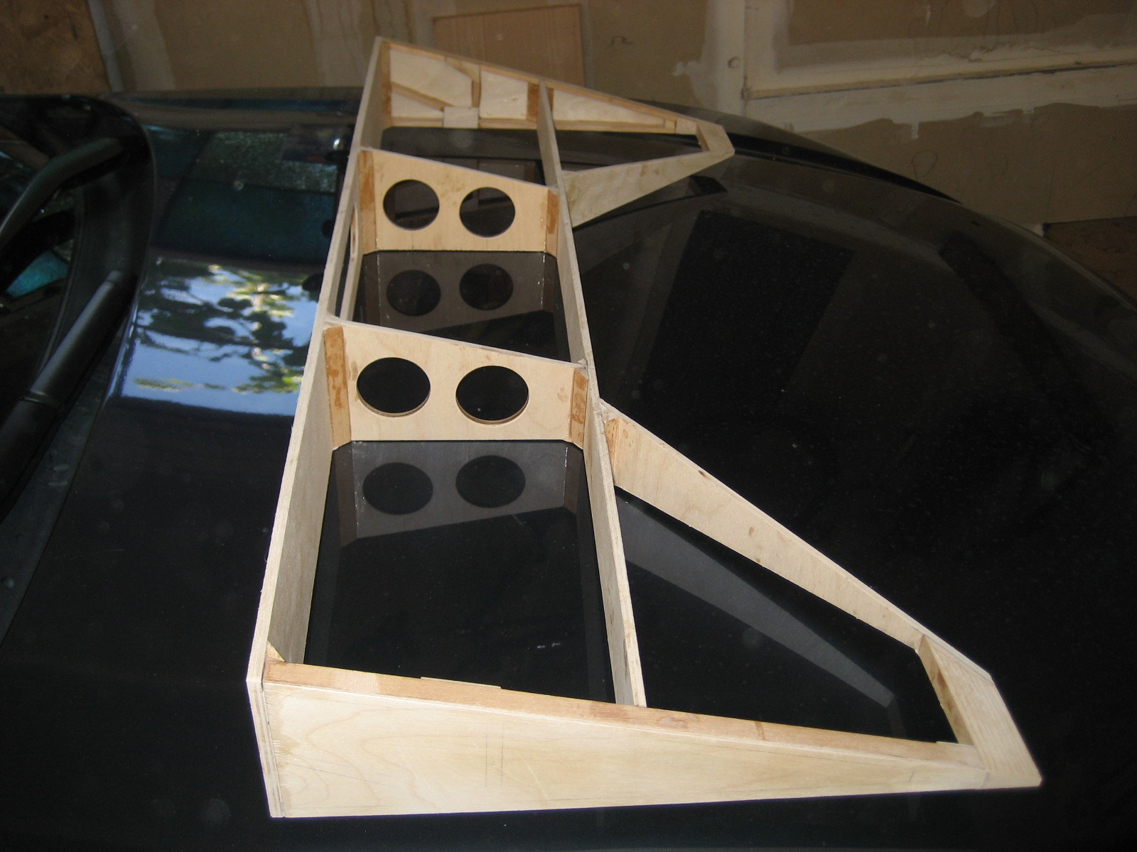

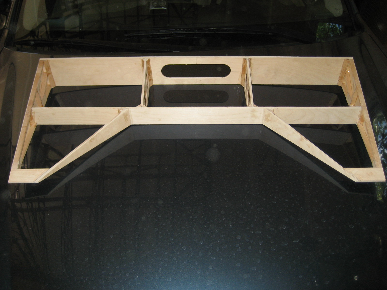

Message 4
| Subject:  | Re: Where are Flop plans? |
      echobravo4 wrote:
      > Hey Grant-
      > I believe the placement of the flop is shown in the 1932 flying and glider plans
      > But I don't think there are any details on how you build it.
      > Seems like it would be similar to making the ailerons
      I just improvised my hybrid flop. Makes it a lot easier getting in an out.
      Rick Holland
      NX6819Z
      http://forums.matronics.com/viewtopic.php?p=415637#415637
