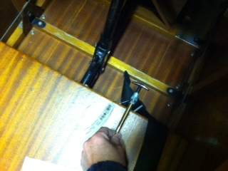

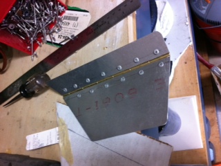

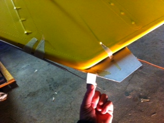

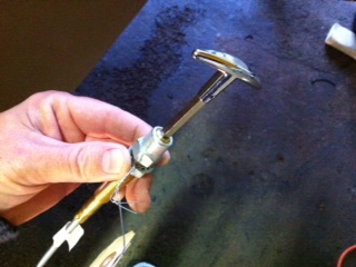

I'm taking advantage of some downtime during Annual by adding a trim tab that can
be controlled from the flight deck. Of course, my AI/DAR will have to approve
it for a sign-off w/said Annual..
I bought a $26 cable from Spruce that locks in any position w/quarter turn of t-handle.
My diabolical plan is to mount it under seat (near right knee). I thought
about the electric trim servo method, but I like staying in the stone age
(no electrics). I will attempt to attach some fotos to this post. I am up for
suggestions/ideas.. if there might be a simpler method out there...
I thought about the bungie/string technique that I've seen on here, but prefer
a "secondary" control, in the event I lose all hydraulics.

may I ask what ur plane weighs and what type of fabric and paint process.. if the
trim works ill try one to

680lbs, stitts polyfiber sys, automobile imron paint on fuse only
KLNC
A65-8
N2308C
AN Hardware
Airframe 724TT
W72CK-42 Sensenich
Standard Factory GN-1
http://forums.matronics.com/viewtopic.php?p=416088#416088
