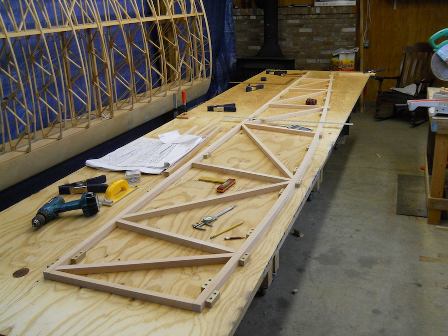

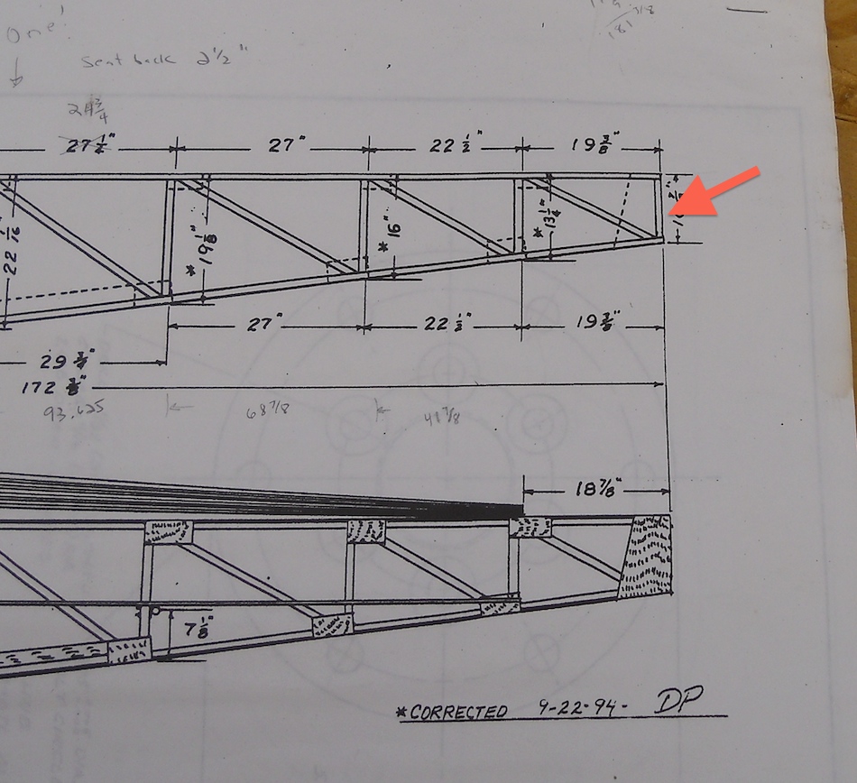

I was building my first fuselage side today and dont understand how to complete
the tail or tail post end. Is a piece of lumber glued into the end like the
plan picture or is this left open and joined with the other side later? The plans
call for a 1x1 tail post piece. Is this it?
John Francis

Message 3
I just rebuilt my tail post. There is indeed one piece that comprises the tail
post. My new one is a bit bigger than 1x1 and is beveled for more contact with
the scarf plates.
So, were I building a fuse from scratch, I'd leave the end open like you mention
and when you join the sides, you can bevel the longerons appropriately and
add the tail post. If you use a piece a little larger than necessary, you can
carve it after joining (rather plane it...) to get it dead nuts vertical (important
for hinge alignment with the rudder) and beveled correctly. Then add the
scarfs. You could put the diagonals in now or later.
I also added a little wedge at the bottom between the longerons just adhead of
the tail post. A 3/8 bolt goes through that holds the tail wheel and is where
my shoulder straps are anchored. It also eliminates a little pocket where moisture
can sit and accumulate when it's on the ground.
While you're there... that upper scarf plate one forward of the tail post scarf
plate. If you lengthen it about 2", it will reinforce the longeron where you'll
likely drill a hole through it for the horiz stab. The plans call for anchoring
the stab with wood screws, but most through bolt it, significantly weakening
the longeron more than a screw would. That's where my longerons broke
during a ground loop.

Message 5
plans call for a 1x1 tail post piece. Is this it?
> Thanks,
> John Francis
John,
Its been ten years since I did this, but I think this is how I did mine.
The tail post is glued in place on both the left and right fuselage
sides. After gluing each fuselage in the jig, allow the glue to cure
thoroughly, then remove each fuselage side from the assembly jig.
Depending on how you set up your jig, one side will already have the
outside gussets in place, now glue on the outside gussets on the other
fuselage side. Turn the fuselage sides upside down on your assembly
table and glue the cross members in place. The fuselage sides are
brought together at the tailpost area, but the two tailposts, as well as
the top and bottom longerons, must be trimmed so that when the left and
right fuselage sides meet at the tailpost, the tailpost width is 1". I
drew layout lines on the top and bottom longerons as well as the two
tailposts. I then trimmed each side with a saw, then trued up the cuts
with a file and sandpaper before gluing.
Attached are a couple of photos.
Good Luck
Rick Schreiber
Valparaiso, IN
Message 6
John,
It's up to you. You can do as Rick did, or you can just leave out the tailpost
until you're ready to join up the fuselage sides. Considerably easier to only
have to bevel the top and bottom longerons than it is to bevel the longerons
AND the tailpost.
I left the tailpost loose until I joined the sides together. You could make the
tailpost a bit wider, as suggested by Tools, and plane off the extra material
before gluing on the rear gusset plates, but the taper is quite slight, and
within T-88's gap-filling abilities if you want to use the standard 1" x 1" tailpost.
Bill C.
