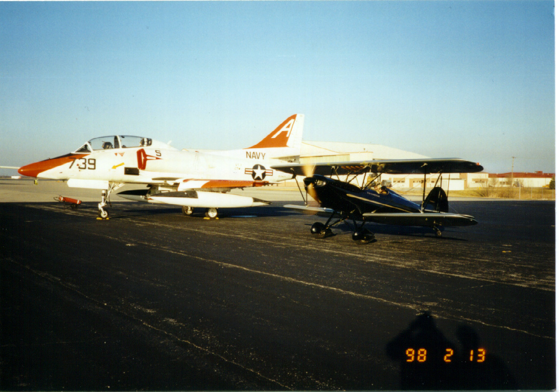

Really? Shows right up on my puter... hmmm...
Lets try this!
http://forums.matronics.com/viewtopic.php?p=417171#417171
http://forums.matronics.com//files/a4_and_hatz_147.jpg

Awesome picture! I am sure your dad loved it.
