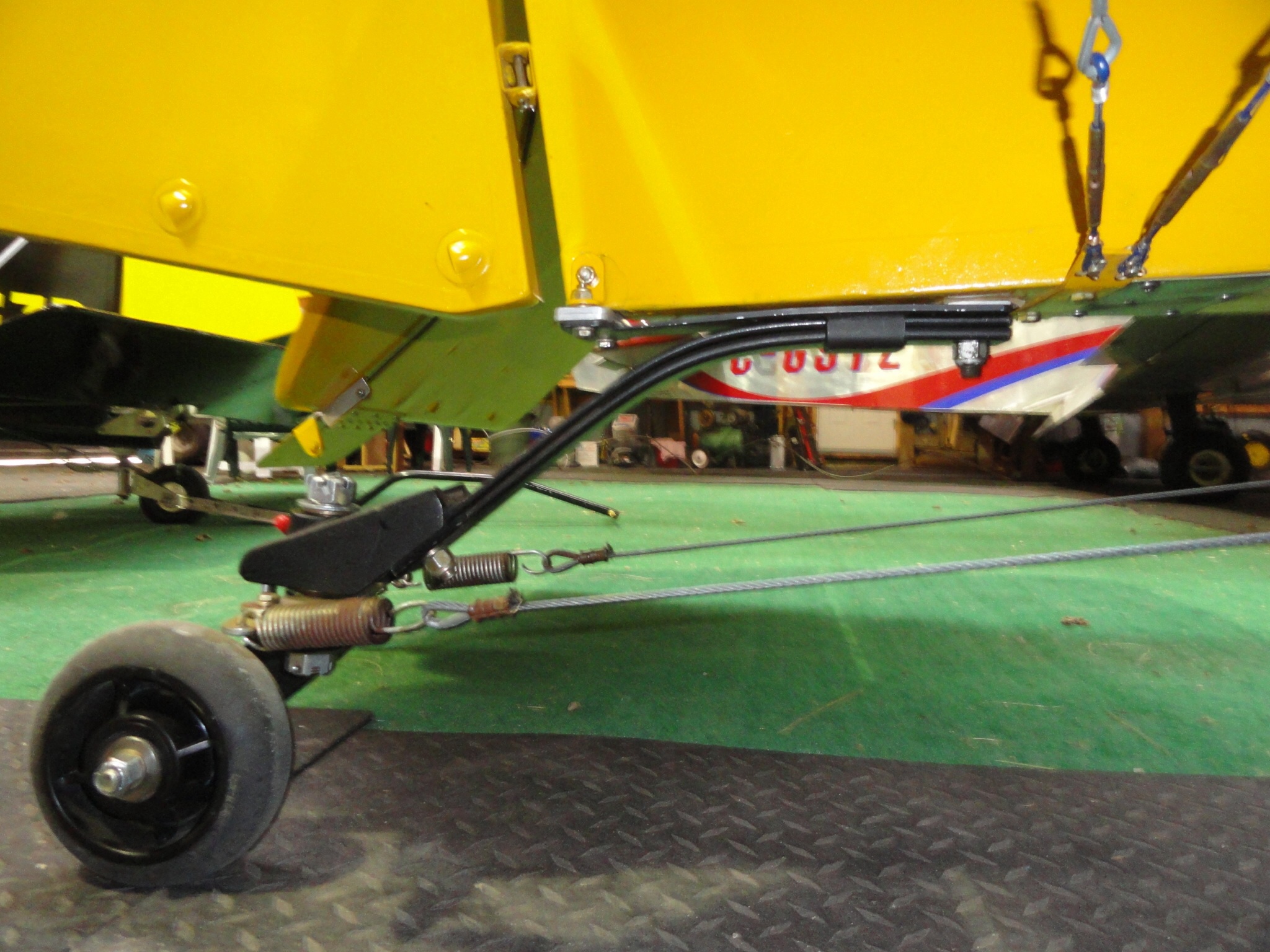

Removed my worn out Maule tail wheel and installed the Matco with the 6" solid
wheel a few years ago and it has excellent.

Adrian,
I noticed your trim tab on the elevator in your picture of your tail
wheel....could you post a few more pictures of it and a brief
explanation on how you have it set up?

Brian
As best as I recall, the tab is approx. 6"x4" riveted to piano hinge and screwed
to elavator with stainless screws controlled by a simple push/pull cable. Broke
off the plastic knob and threaded the swagged end for 10/32. Used a turnbuckle
for adjustment with an aluminum knob press fitted over the barrel.
Precise adjustment with no drift.
