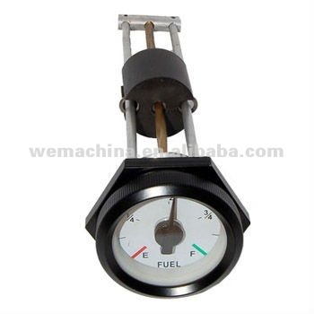

      Gary; the fuel tank really is a nice piece of work.  I was just funnin' ya about
      the rivets, but now't you mention it, I see the dimples and why you had to offset
      the rivets in those spots.
      By any chance are you using a Larry Williams-style fuel sight gauge on the bottom
      of the tank, or a dial-type, or electric capacitance, or -?  I think I've also
      seen someone's  centersection tank that used one of the old outboard motor
      fuel tank gauges that feature a cork float that turns a flat helical piece of
      metal as the float rises or falls.  The twisting of the flat rod turns the fuel
      indicator needle.

Message 11
| Subject:  | Re: Fuel flow question |
      A picture of the typical float-type indicator is attached.  However, I think these
      are mostly made for viewing from above, which means that they would read exactly
      the opposite if installed in the bottom of a fuel tank for viewing from
      below.
