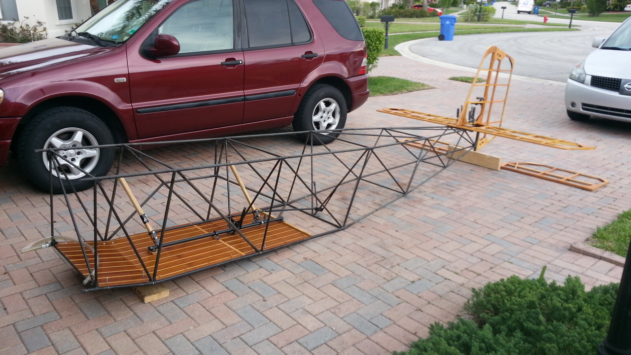

| Subject:  | nx727cr build update |
      Have been welding tabs all over the fuselge.  Just finished the ones that will
      allow me to fasten horiz stab on and couldnt resist clamping tail pieces in place
      for a photo op. If curious, the airframe, floor, and cockpit controls as you
      see in pick add up to 51lbs 6 oz. (Tail feathers are excluded).[/u]
      Paul Donahue
      Started 8-3-12
      http://forums.matronics.com/viewtopic.php?p=418136#418136
      http://forums.matronics.com//files/20140205_150401_210.jpg
Message 4
| Subject:  | Re: nx727cr build update |
      Paul, looks great.  Love the floor. Ken
