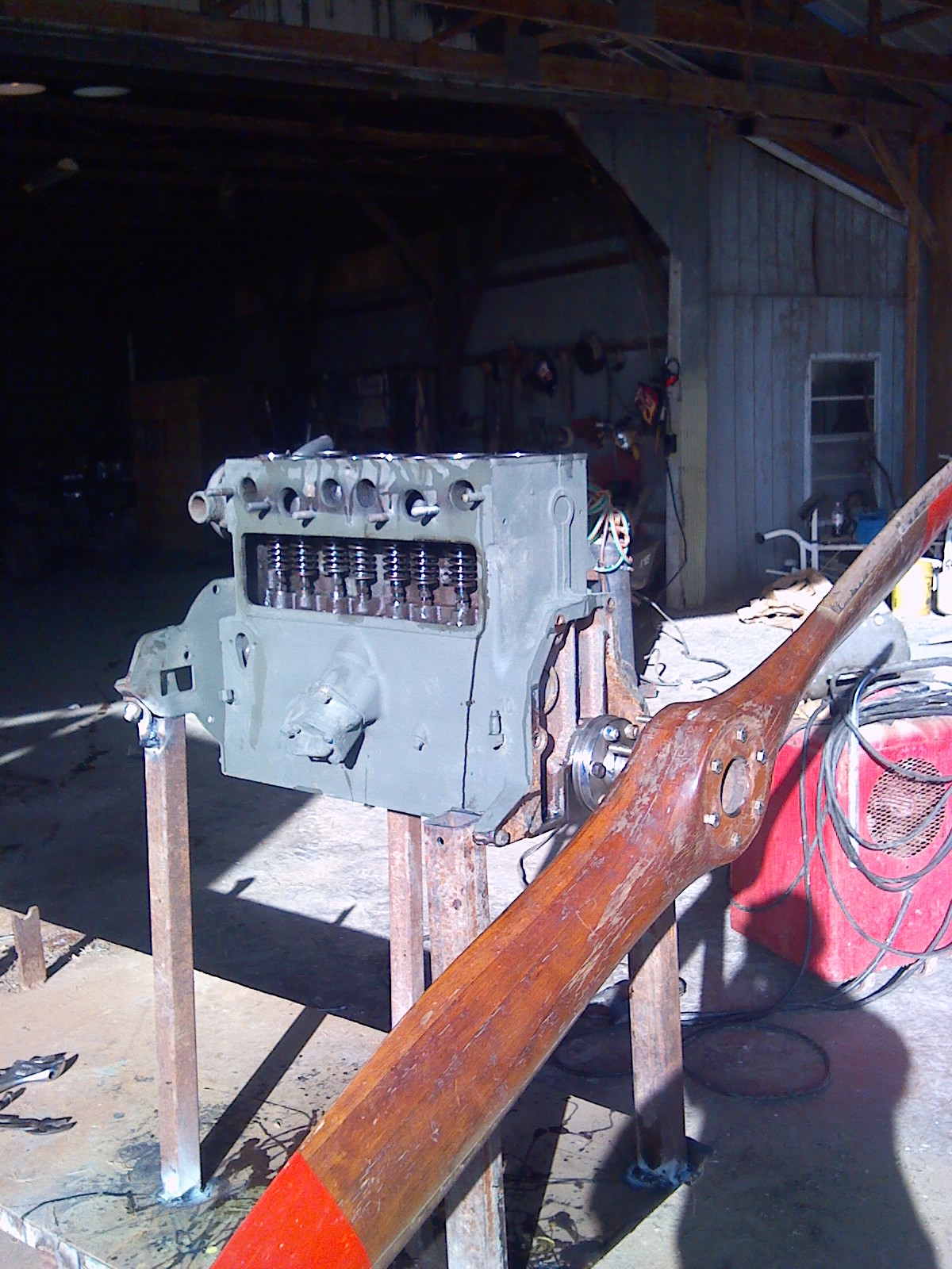

Hi Guys. I need some advice. I have a commercial type band saw that uses
a 93 inch blade. It is really for wood, but I have slowed it down with a
jack shaft I made, and it is slow enough now. I tried to rip some .100
4130 and it quickly ruined my blade. Is this not going to work. I need to
come up with some way to make this thing work.
I've been making some progress on my fuselage and hopeing to finish it
by spring then move on to the wing when time allows
http://forums.matronics.com/viewtopic.php?p=418163#418163
http://forums.matronics.com//files/jeep_motor_1_118.jpg
http://forums.matronics.com//files/controls_2_491.jpg
http://forums.matronics.com//files/controls_1_908.jpg

I love the Jeep motor! Are you going to mount it high and sticking up or
somewhat lower with the prop at a lower position? It could look very
OX5ish.
