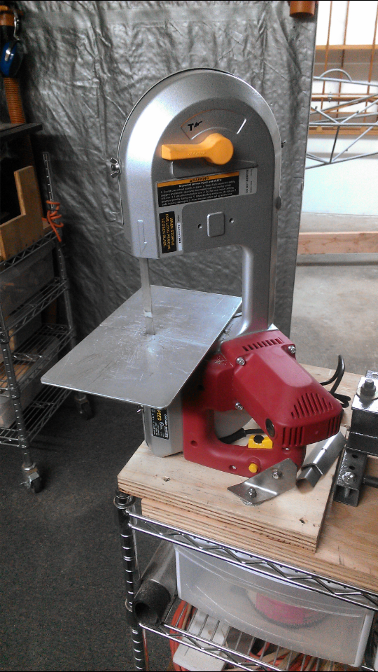

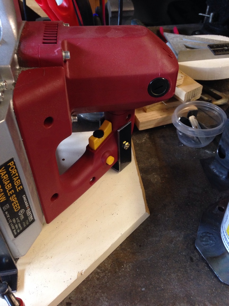

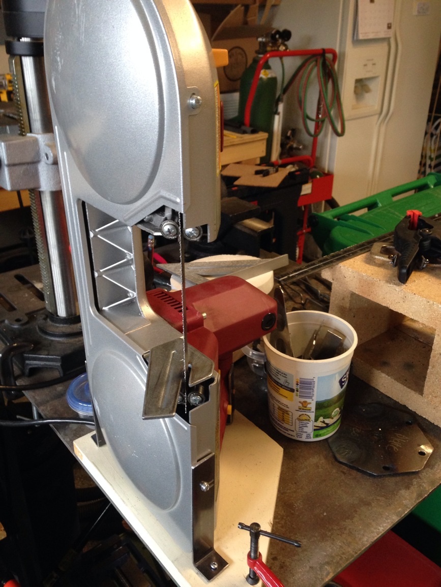

      A special thanks to Jake Schultz for his setup. I did mine very similar to his
      also but without a new bed. Works great! Just 3 little strap steel brackets and
      a piece of wood.

      hanks for the kudos.... Can't imagine cutting all the 4130 without this small bandsaw.
      It's from Harbor Freight but it is the only portable metal bandsaw I know
      of hhat "twists" the blade so you can cut an infinite length or width of stock.
      I use reaal good "milwaukee" 24 tooth blades. It will cut through 4130 plate
      all day long with no fluids. You sure so need hearing protection, however.
      Picked up some brand new Honda ATV brake calipers and the welder comes again in
      two weeks - gotta get more done on the landing gear before he arrives.....
