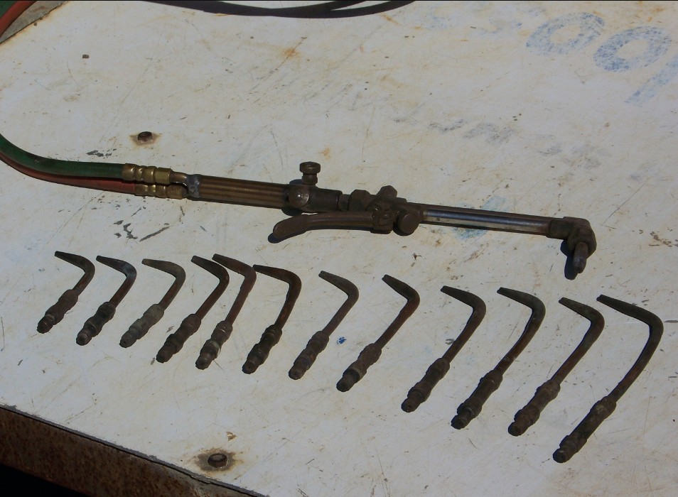

      I have never had a Cobra torch in my hand but would like to comment anyway. I have
      a Smith Airline torch that was my Dad's. He welded engine mounts for North
      American during WWII, then engine mounts and landing gear for Luscombe and Swift.
      My opinion of quality welds depends mostly with the skill of the person with
      the torch in their hand. I did all my Piet welding with the Smith except the
      engine mount just for nostalgia sake. My son welded the mount with my Miller
      330 tig machine.
       The idea that the Cobra is hotter than a regular torch is advertising BS. Fuel/oxygen
      ratio determines flame temp. All that said I don't claim to be an expert........just
      seen a lot of welds. There is absolutely no substitute for a good
      set of regulators that hold a setting. Victor 2 stage is my favorite but pricey.
        Notice how many tips are there in the picture. Having the right size tip makes
      you look better than you really are!
