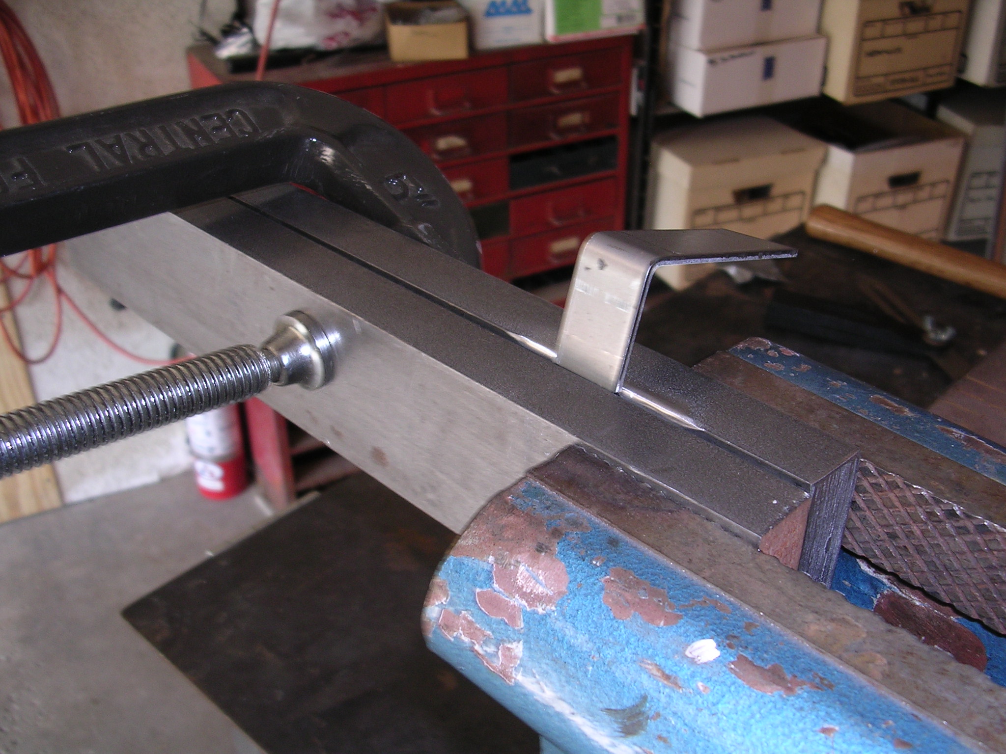

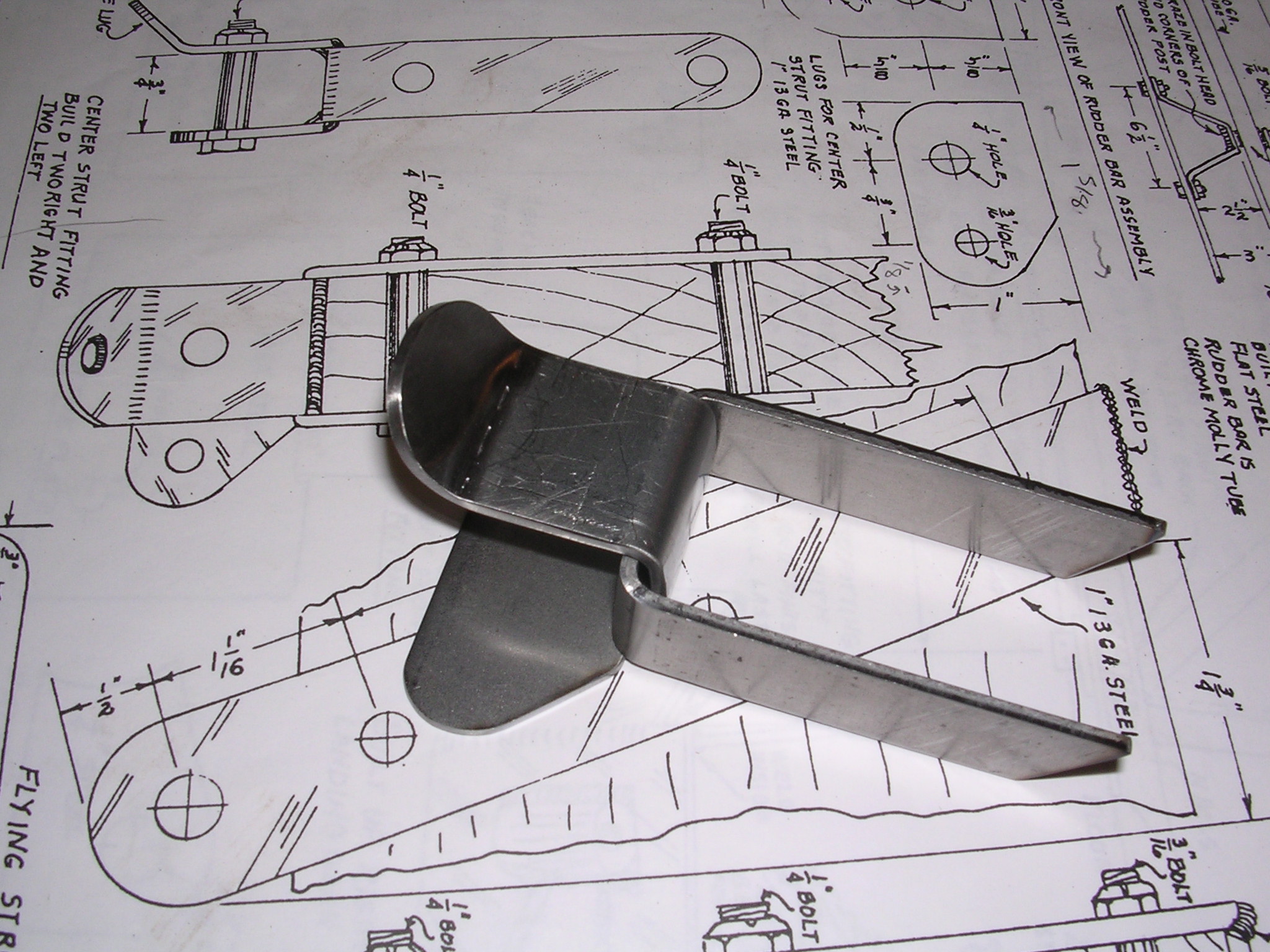

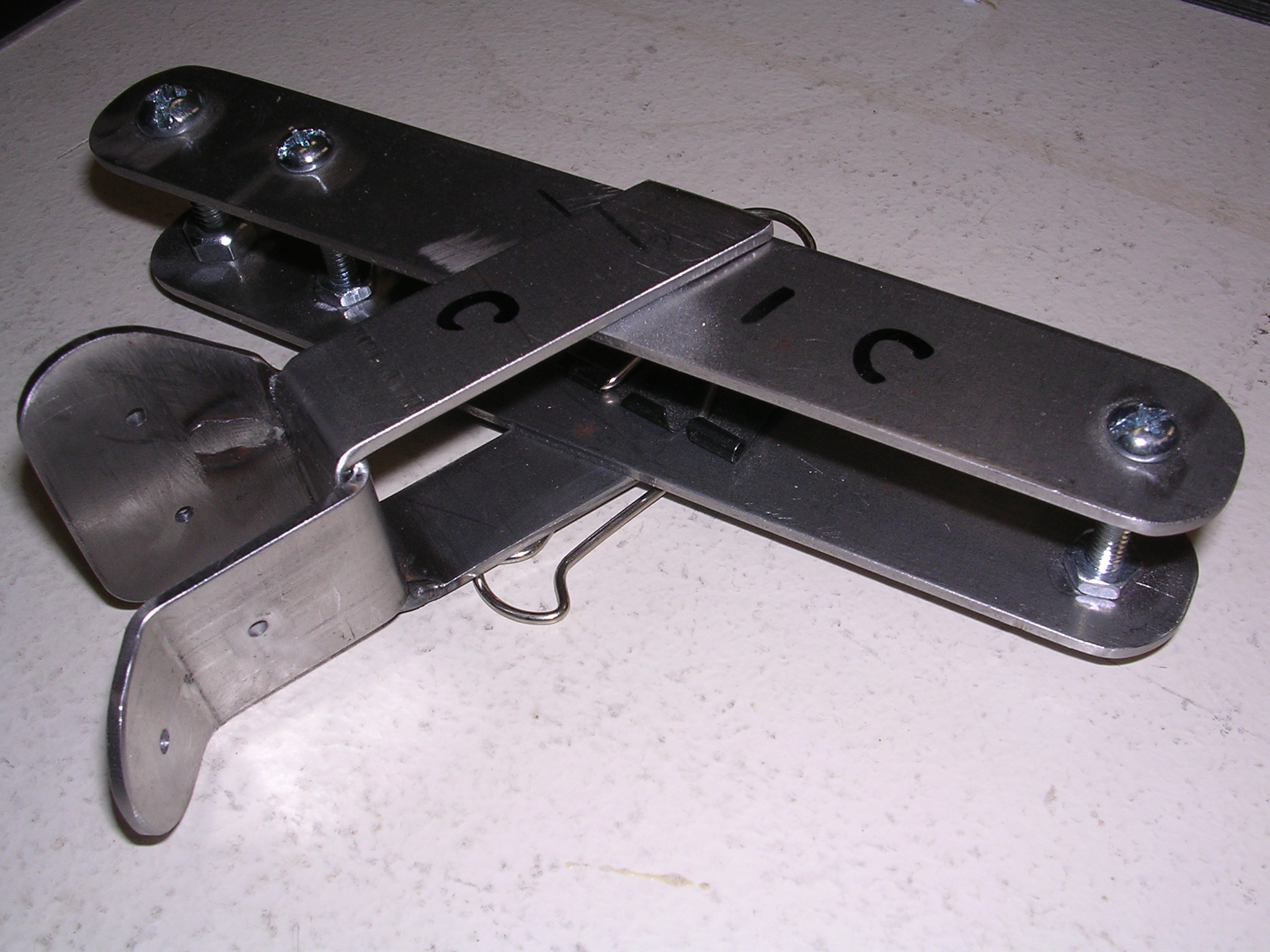

Message 4
| Subject:  | Re: More files from the Galacticly inept Piet builder |
      Bob here are a couple of shots from my site showing my makeshift brake.
      http://www.textors.com/cabane_fittings_010.jpg
      http://www.textors.com/cabane_fittings_015.jpg
      http://www.textors.com/Horns_005.jpg
      Jack Textor

      builder
      Bob
      You didn't ask me but here is my answer. I would not use part C and it is
      unlikely you could make it the correct size if you tried to fix it.  Part B
      left side is your best bend.  You might be able to salvage B but it's
      probably not worth the effort.
       I think you have something wrong with your technique. I found that using
      wood forms, like the yellow book shows, for material this thick would crush
      the wood and make the bend radius too large and not produce nice bends.  My
      results were very similar to your results. Maybe it works with aluminum but
      I have not tried it. What I ended up doing is taking a piece of 3/8-inch
      6-inches long x 2-inch wide steel bar (scrap I picked up at a scrap metal
      dealer). The dimensions don't need to be exact.  Make the correct  radius on
      one edge. As others have said 4130 can have a 1xthickness bend radius for
      the 90 degree bend. Also, if you're trying for a 90 degree bend you will
      have to bend it past 90 so you will have to grind off some of the top of the
      bar like the book shows.
       In this picture
      http://westcoastpiet.com/images/Chris%20Tracy/images/IMG_0048.JPG you can
      see that I have the part to be bent sandwiched between the radiused bar and
      another one that acts as a backer for the fitting (in this case the rudder
      horn). You will want to hit the metal to be bent close to the bar so the
      bend all happens along the bar. I found hitting it with a hammer left marks
      so I use a chunk of wood or better yet a bronze rod I found at the scrap
      yard.
      For the fitting that your trying to make, I made the first 90 bend in the
      vice like in the picture.  Then to form the U I had to clamp it off the end
      of the vice and use a C-clamp to hold the other end. This will require you
      to figure out your bend layout (like in the blue Bengals book?) but it is
      not hard. What you are striving for are flat side with a nice bend.  Not
      curved like in the bottom of your part C.  If you need any more help I can
      shoot some better pictures of the process.
      The best thing I made to bend parts was this.
      http://westcoastpiet.com/bench-top_bender.htm >  It makes for easy bending
      and reproducibility.
      Chris T.
      Sacramento, Ca
      Westcoastpiet.com
