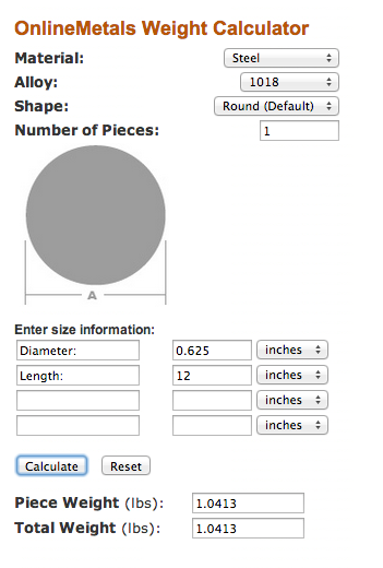

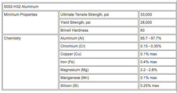

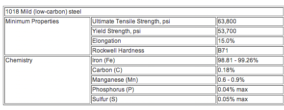

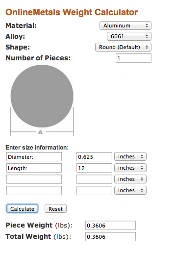

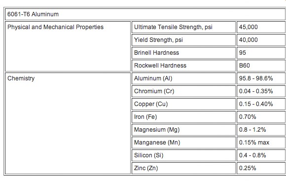

Oscar,
Does any of this help?
Semper Fi,
Terry Hand
Athens, GA
http://forums.matronics.com/viewtopic.php?p=418781#418781
http://forums.matronics.com//files/screen_shot_2014_02_16_at_74611_am_512.png
http://forums.matronics.com//files/screen_shot_2014_02_16_at_74536_am_305.png
http://forums.matronics.com//files/screen_shot_2014_02_16_at_74329_am_589.png
http://forums.matronics.com//files/screen_shot_2014_02_16_at_74218_am_165.png
http://forums.matronics.com//files/screen_shot_2014_02_16_at_73944_am_721.png

Terry; yes, those tables are of some use but I would have to calculate the section
moduli and all of that, to get a good cross-reference of an aluminum tube
that is equivalent to steel. Rainy day activity ;o) Thanks.

I was a section leader when I flew in the Marine Corps but I know nothing about
section moduli.
Let us know what you find out. I would be curious to know how aluminum tubing compares
with 1018 steel. FWIW, those screenshots came from onlinemetals.com
