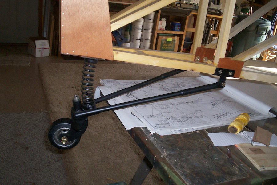

Message 4
| Subject: | Tail Wheel Spring |
My tail wheel assembly was built by Ken Perkins. Although he has it so the spring
twists into place, is it tack welded to hold it in place? This is not a
picture of my setup, but is close.
John Francis
http://forums.matronics.com/viewtopic.php?p=419427#419427
http://forums.matronics.com//files/tailwheel_installed__longer_107_207.jpg
Message 5
| Subject: | Re: Tail Wheel Spring |
John, you may not want to take the assembly apart to do this, but...
When I made mine, I cut tabs around the spring cups. (attached) Then once the assembly
was installed, I bent a few of these over to retain the spring.
If God is your co-pilot...switch seats.
Michael Perez

Message 8
Michael,
In other words, you followed the plans? Good idea.
The photo John attached appears to show the same method.
There should be no need to tack weld the spring. Welding springs is generally
not a good idea, since it will affect the temper of the steel.
Once installed, if the spring were to (somehow) rotate, it would "bottom out"
at either the top or bottom end, and not be able to rotate any further and unscrew
itself.
Bill C.
http://forums.matronics.com/viewtopic.php?p=419440#419440
http://forums.matronics.com//files/tail_skid_204.jpg

Message 10
Yes, I know, I know...this is one place I did just like the plans showed. (One
of only a few.)
Michael Perez
Pietenpol HINT Videos
Karetaker Aero
www.karetakeraero.com
