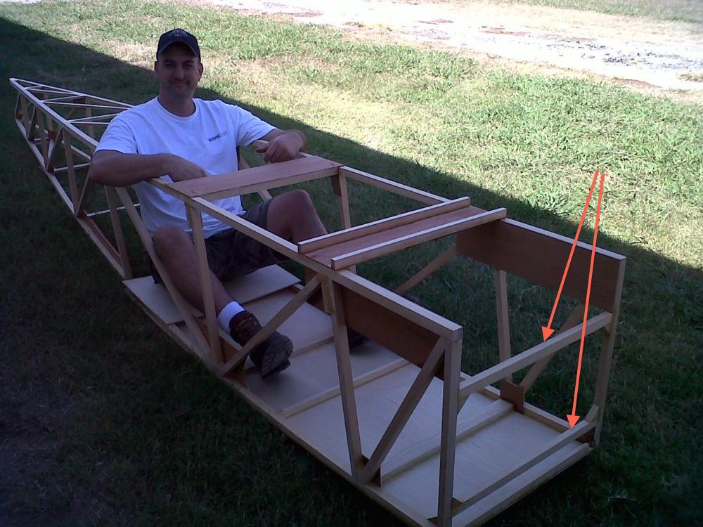

Message 4
I cant find these two cross braces on the plans. Can anyone enlighten me as to
why they are there?
John Francis
http://forums.matronics.com/viewtopic.php?p=420145#420145

Message 5
| Subject: | Re: Cross Braces |
John
look at the plan sheet labeled Drawing No. 1. (upper right corner) There are some
detail drawings in the lower right corner of this sheet. Look at the one for
the fire wall. You will see the upper one is for the engine tray and the lower
is to back up the firewall to floor joint.
Chris
Sacramento, CA
WestCoastPiet.com
http://forums.matronics.com/viewtopic.php?p=420150#420150
Message 6
Woops, I see you have two lower braces. I'm guessing the builder added another
one because the lower one interferes with the lower engine mount fittings and
has to be trimmed short of the side.
This is what some would call a builder improvement............. but is likely not
needed.
Chris
Sacramento, CA
WestCoastPiet.com
http://forums.matronics.com/viewtopic.php?p=420152#420152
