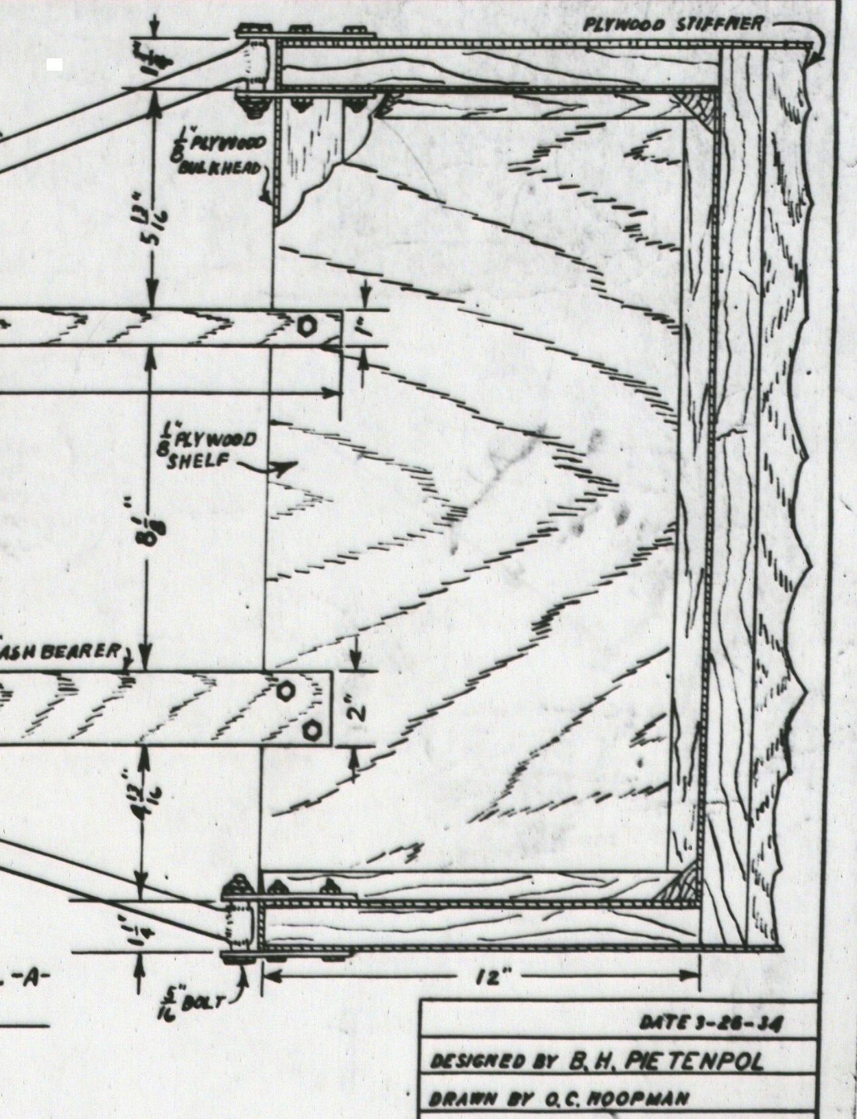

      Did I read the plans wrong?  Note in the red oval on the print, "all
      measurements to outside of plywood=C3=A2=82=AC=C2=9D.  I assumed this me
      ant all measurements
      and made the front of my fuselage 24=C3=A2=82=AC=C2=9D wide to the outsi
      de of the plywood.
      Yesterday I borrowed a WW corvair engine mount and found it to be a 1/4=C3
      =A2=82=AC=C2=9D too
      wide for my frame (the engine mount measured 24 1/4=C3=A2=82=AC=C2=9D wi
      de).  That would mean
      that the front, or far left dimension on the print should be 24 inches to t
      he
      outside of the longerons and not the plywood.....correct?  Before I remove
      the
      two bottom ash cross struts connecting my sides, I want to make sure.
      John

      Just to muddy the waters a little more, refer to drawing No. 6.  This seems to
      be the only place in the drawing set that cannot be interpreted in more than one
      way.  The detail clearly shows the dimensions to be to the outside of the plywood
      side skins.  The dimensions are:
      1 1/4" + 4 13/16" + 2" + 8 1/8" + 1" + 5 13/16" + 1 1/4", which gives a grand total
      of 24 1/4" including the plywood skins, or, 24" to outside of longerons.
      This seems to be in conflict with the note on drawing No. 1, which says all dimensions
      to outside of plywood.  Unless we interpret that note to be referring
      to the plywood floor.
      Having said that, I can't remember whether I built my fuselage to be 24" wide,
      measured at the longerons, or measured at the plywood.  And, to be honest, it
      doesn't matter.  At all. One quarter inch difference in the width one way or the
      other will not make a significant difference.  And if you will be building
      your own motor mount, simply build the mount to suit the fuselage width you have
      fabricated.  If you will be having your mount built by others, either confirm
      the mount width before building your fuselage, or give your fabricator clear
      instructions as to your mounting point dimensions.
      Bill C.

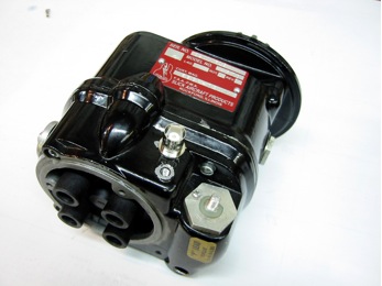

| Subject:  | Magneto switch wiring |
      Hello,
      I have a pair of Slick magnetos in the a65 engine, and the switch key for R-L-Both
      or off.
      >From where does the cable/es  from the mag to the switch key depart?... I was
      traying to find a diagram but I do not find anyone, and I do not see nothing over
      the mags.
      thanks in advance.
      regards
      Mario Giacummo
      Photos here: http://goo.gl/wh7M4
      Little Blog   : http://vgmk1.blogspot.com
      http://forums.matronics.com/viewtopic.php?p=420470#420470
Message 14
| Subject:  | Re: Magneto switch wiring |
      Mario; are you asking about the attachment stud for the wire on the magneto, or
      on the switch?
      Oscar Zuniga
      Medford, OR
      Air Camper NX41CC "Scout"
      A75 power
      http://forums.matronics.com/viewtopic.php?p=420476#420476
Message 15
      My question was bad...
      from the switch that is on the cockpit, I have to send cables to the magnetos,
      but I do not know where to wire them (at the mag side)..
      the mags are Slick 4333...
      PD: como conecto los magnetos a la llave?
      Mario Giacummo
      http://forums.matronics.com/viewtopic.php?p=420480#420480
      http://forums.matronics.com//files/p1011201_170.jpg
      http://forums.matronics.com//files/0558_738.jpg
      http://forums.matronics.com//files/descarga_157.jpg
Message 16
      Mario; the orange wire "jumper" on the magneto must be removed... I think it is
      only there to temporarily ground the ignition P-lead from the magneto.  I'll
      get the detail from Tony Bingelis' book... then we will start a discussion about
      whether the shield braid on the P-lead wire should be grounded at both ends
      or only at one end ;o)
      Oscar Zuniga
      Medford, OR
      A75 power
      http://forums.matronics.com/viewtopic.php?p=420482#420482

Message 18
      William,
      There is only one way for a curmudgeon to look at things. But in this case
      Mr. Church has found that (gasp) there might be a conflict on the plans? Th
      ere must be some plausible explanation for this. I will search the "papers"
       in May.
      Dan Helsper
      Puryear, TN
      -----Original Message-----
      From: William Wynne <WilliamTCA@aol.com>
      Sent: Mon, Mar 17, 2014 8:19 am
      Subject: Pietenpol-List: Re: Rats!
      Dan,
      That may not have come out the way you intended, but the Corvair mount I bu
      ilt
      for Bob Dewenter (that John has on hand) isn't 'Wrong' if it fits Bob's pla
      ne
      like a glove. We made it for Bob after his fuselage was built, to the exact
      width dimensions he sent. The point I was trying to make is that we can eas
      ily
      make them from 23.5" to 24.375" in the same fixture.
      Between Pietenpols, KR-2s and Firpies (wooden Vision fuselage) I have made
      about
      a half dozen 'De Havilland box' construction style fuselages in the last 20
      years. In all of these, I put the outer plywood on the sides while they wer
      e
      still flat on the bench. This steers a builder toward a 24" wide fuselage.
      >From looking at builder's photos, most people appear to just build the sid
      e
      trusses with the inner gussets, and then stand them up with no skin. I am
      thinking that most of those people end up with a 24.250" wide fuselage, how
      ever,
      a guy could use this technique and still build a 24" wide plane.
      My reading of the plans is the same as yours, that the overall fuselage wid
      th,
      with the plywood is intended to be 24". But if I made every mount that way
      some
      of them would not fit. John is only working with Bobs mount because he just
      ordered one from us, and intends to pick it up at Brodhead. I can easily ma
      ke it
      a clone of Bob's or I could make it 24" to suit either width. -ww

      Attached are some photos that might help.  At the magneto, I grounded the braided
      wire shield and then I used a rubber boot to cover the P-lead lug.  At the
      ignition switch, I connected the P-lead wires from the magnetos to the Right and
      Left magneto connections and ran a ground wire from my common ground reference
      lug (a stud on the metallic firewall) to the Ground connection on my ignition
      switch.
      I have a flexible braided grounding strap from the engine block to the ground reference
      lug on the firewall, too.
      Oscar Zuniga
      Medford, OR
      A75 power
      http://forums.matronics.com/viewtopic.php?p=420521#420521
      http://forums.matronics.com//files/ignswitch_708.jpg
      http://forums.matronics.com//files/magwire_596.jpg
