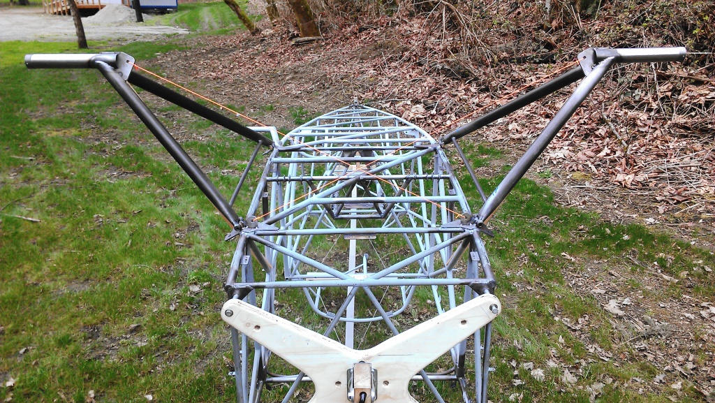

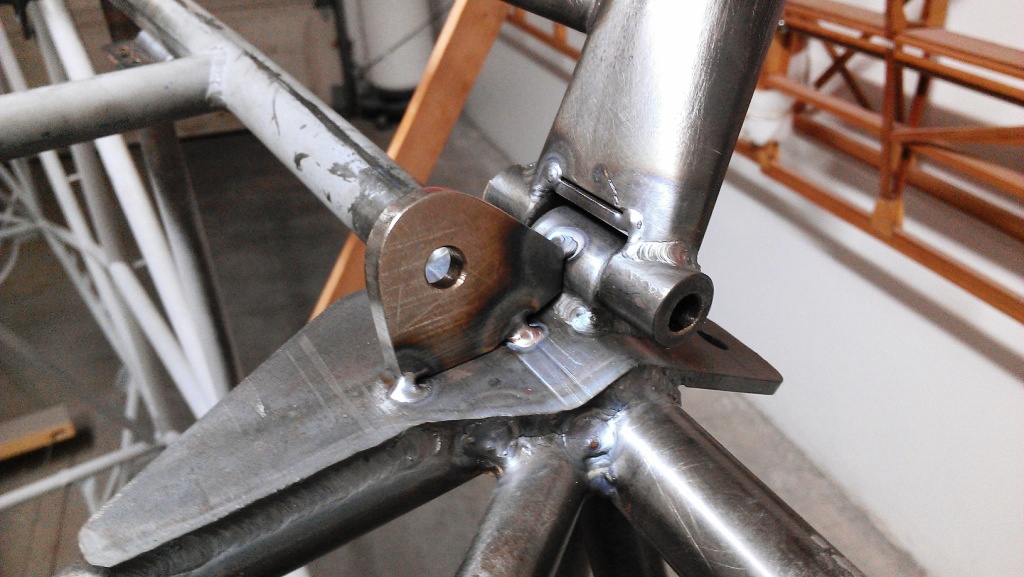

Message 11
| Subject: | Steel-tube fuselage update - landing gear welded |
Hello good Piet-ple,
Hope the sun was shining where you live. It was sure shining in Seattle the past
few days...! [Rain for the next week however :-( ]
Mike from "ready Weld" made another visit and performed more of his craftsmanship
magic.
FYI my axle was moved 3 1/2" forward - to move the CG of the plane forward and
make the plane less likely to nose-over. (Hey, wasn't that topic discussed on
this message board recently...??) THANK YOU ALL for bringing that information
up for discussion.
THE FUSELAGE FRAME IS NOT YET COMPLETE - AS I WILL BE ADDING AN ADDITIONAL CROSS-PIECE
BETWEEN THE WING STRUTS. (Several owners have had the cross piece fail
in compression - so this additional structure NEEDS TO BE ADDED in order to prevent
this situation.) I had cut the cross-piece tubing but since Mike had already
put in almost 12 hours we decided to weld them in next time.........
I tried to take photos from angles that would be helpful.
Please note that I have not yet completed or flown this plane so do not take any
of this info as proven...(!)
Hope all of you are enjoying YOUR Pietenpol adventures/journeys...!!
Jake
Jake Schultz - curator,
Newport Way Air Museum (OK, it's just my home)
http://forums.matronics.com/viewtopic.php?p=420937#420937
http://forums.matronics.com//files/lg_1_359.jpg
http://forums.matronics.com//files/lg_2_126.jpg
http://forums.matronics.com//files/lg_3_212.jpg
