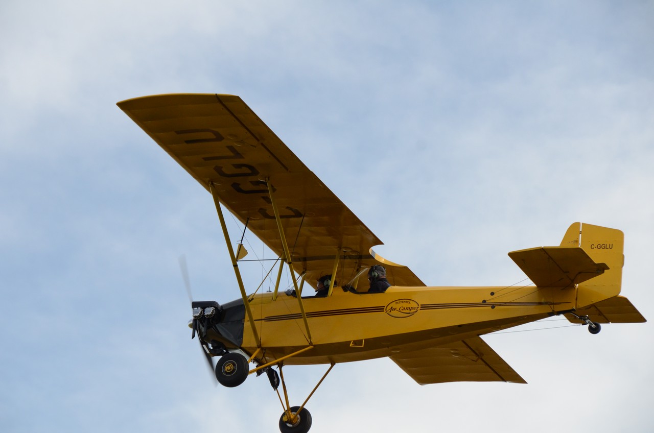

      And still more droopiness
      Adrian M
      Winnipeg, MB
      Canada
      http://forums.matronics.com/viewtopic.php?p=421244#421244
      http://forums.matronics.com//files/adrian_and_debbie_flying_7_200.jpg

      fattest pilot?

      Maybe it's just me... but isn't the only real factor affecting elevator position
      in level flight, the speed?
      My piet has a pronounced up elevator position... in the flare.  Does every time.
      Pretty sure EVERY piet would have a certain speed where the elevator would
      be in a neutral position.  All these pics are likely taken at different speeds,
      meaning the elevators would be in different positions.
      Isn't it really just that simple?
      Now, if your elevators are somewhat down, and the plane is in trim (no control
      stick pressure), and this bothers you (since the elevators are not faired, there
      will be more drag than necessary, so you'll be somewhat slower - maybe not
      even noticable), you either change the wing incidence, or the horiz stab incidence
      to take that out.  It's a simple matter of rig.  Which you do (the stab or
      wing) is also a matter of rig, and should be based on keeping the fuse angle
      of attack at a minimum to reduce frontal area, and decreasing drag.
