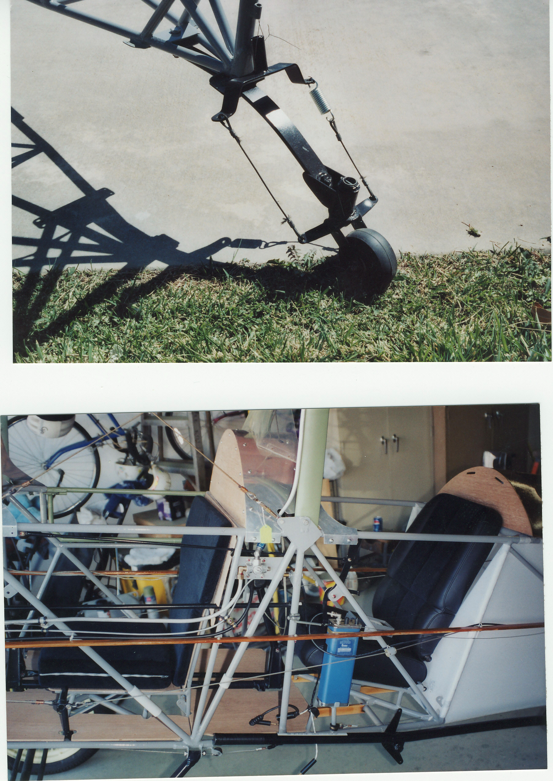

    Steve, Attached is a side view of mine. I assume you guys are talking about the pilots seat. The top of my seat back cross member is moved two inches to the rear. That makes it a little reclined. The cushions I have are actually Cessna 150 seat cushions. It may be tricky to do if you fuse is already built. We did this modification to mine back in the 1980's. Like Gary said, it is very comfortable. The front seat lower cushion is that expensive triple layered/density foam about 3 inches thick and the seat back is just a one inch single density foam. The only down side to the lower cushion is that it is as hard as a rock when it is cold out. When cold out I put it in my truck with the heater blowing on it during pre-flight to soften it up. So, there you go. Maybe this helps. -------- Scott Liefeld Flying N11MS since March 1972 Steel Tube C-85-12 Wire Wheels Brodhead in 1996 Read this topic online here: http://forums.matronics.com/viewtopic.php?p=422660#422660 Attachments: http://forums.matronics.com//files/piet_105_126.jpg

    Good second picture but the first "seat" picture sure looks like a tailwheel...!! LOTS of wonderful information in that fuselage side view - thanks...! -------- Jake Schultz - curator, Newport Way Air Museum (OK, it's just my home) Read this topic online here: http://forums.matronics.com/viewtopic.php?p=422665#422665

    Funny you commented about the tailwheel pic. Both of those pics were scanned together and are now one attachment. Consider it to be a bonus Pic. BTW, I changed out that tailwheel assembly because it made the plane handle like a Pitts when landing. The new assembly makes it a pussy-cat to land now. -------- Scott Liefeld Flying N11MS since March 1972 Steel Tube C-85-12 Wire Wheels Brodhead in 1996 Read this topic online here: http://forums.matronics.com/viewtopic.php?p=422666#422666

    That Photo (the sideview, not the tailwheel) motivates and inspires me to make it like your rear seat.It also gives me ideas for the front seat. Thanks for posting them. BTW Looking at your steel tube fuselage. It has a very different feel than the Wood frame. Man that looks like a generation newer technology. radio mounts fittings attached to metal tubes. Also are the front to rear bracing wires on the left side of the front seat standard? I have not seen that on any Piets or Gregas. Thanks again, I learn and am often motivated by almost every photo of a Piet I see. Blue Skies, Steve D On Thu, May 1, 2014 at 8:32 AM, AircamperN11MS <Scott.liefeld@lacity.org>wrote: > Scott.liefeld@lacity.org> > > Steve, > > Attached is a side view of mine. I assume you guys are talking about the > pilots seat. The top of my seat back cross member is moved two inches to > the rear. That makes it a little reclined. The cushions I have are > actually Cessna 150 seat cushions. It may be tricky to do if you fuse is > already built. We did this modification to mine back in the 1980's. Like > Gary said, it is very comfortable. > > The front seat lower cushion is that expensive triple layered/density foam > about 3 inches thick and the seat back is just a one inch single density > foam. The only down side to the lower cushion is that it is as hard as a > rock when it is cold out. When cold out I put it in my truck with the > heater blowing on it during pre-flight to soften it up. > > So, there you go. Maybe this helps. > > -------- > Scott Liefeld > Flying N11MS since March 1972 > Steel Tube > C-85-12 > Wire Wheels > Brodhead in 1996 > > > Read this topic online here: > > http://forums.matronics.com/viewtopic.php?p=422660#422660 > > > Attachments: > > http://forums.matronics.com//files/piet_105_126.jpg > > -- Blue Skies, Steve D

    Steve, Yes the cross wires are on the left side on my plane. We put a door in for the front seat on the right side of the plane. The door is on the R/S to allow for no disruption of the throttle linkage on the L/S. Most Piets have the cross wires on the right hand side. There are also some Piets out there without any cross wires. My forward diagonal cabane supports are not very large in diameter and I feel better having the cross cables for the extra support in a sudden stop. If that makes any sense. -------- Scott Liefeld Flying N11MS since March 1972 Steel Tube C-85-12 Wire Wheels Brodhead in 1996 Read this topic online here: http://forums.matronics.com/viewtopic.php?p=422674#422674
