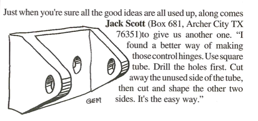

| Subject: | Elevator & rudder hinges from square tubing sections |
Getting ready to fabricate elevator and rudder hinges. Rather than the multi piece
weld up on the plans I was going to try sections of telescoping 1in and .75
in .065 wall square 4130 tubing. Easier to fabricate and the multiple .065
walls would give more bearing area than the .090 welded up hinges. Also would
require no welding(a plus in my book!) Plan tonuse AN 3 bolts with castle nuts
as the hinge pins.
Wondering if anyone has already tried this. Thoughts from the group?
Grant Ziebell
Savannah, TN
http://forums.matronics.com/viewtopic.php?p=423924#423924

| Subject: | Re: Elevator & rudder hinges from square tubing sections |
Grant,
That sounds terribly heavy and unproven. You should reconsider since there is absolutely
no reasons to beaf up the structure. There has never been a known structural
failure on a plans built Piet. You also need to keep a very close eye
on any weight you add to the back and of these birds. Please reconsider.

Grant,
Pardon my previous post. I must be tired. Somehow I thought you included the control
horns in the question. For hinges it may work.
I tried this method. The hinges work out OK=2C but I am not happy with my p
recision in locating the holes in opposite 'ears.' I am using clevis pins
=2C secured with cotter pins=2C as the hinge shaft. Each hinge half gets a
single 3/16 AN bolt as attachment. This requires a slight inset cut in the
wood to prevent rotation. I've already mounted the elevator sets=2C but not
the rudder set. I get full travel on the control surfaces=2C but I am not
happy with the alignment. I'm looking for a set of the 'original' Vi Kapler
hinges.
Lorenzo
