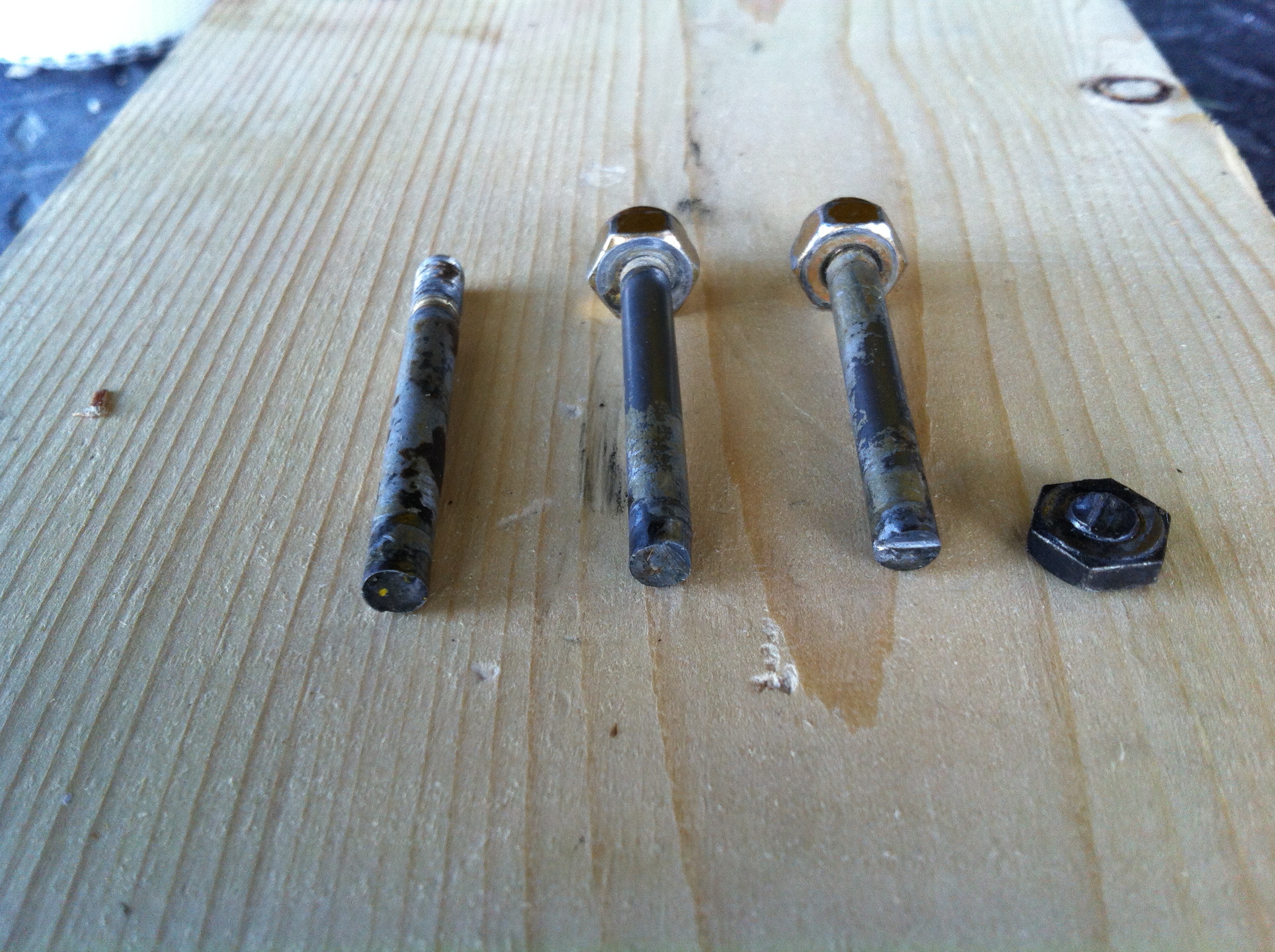

| Subject: | Landing Gear's AN3 bolts sheared - replaced with AN3 or |
AN4?
Had an adventure landing yesterday when 2 of 4 landing gear bolts sheared off so
gear collapsed on landing - no damage. 3rd bolt sheared when removing it to
replace all 4 with new bolts. Have photos if interested.
Has anyone else had this problem and did you replace with AN3 as per drawings or
enlarge to AN4s?
Also - thinking of putting a safety cable in case bungy cables go. Do you know
how long the cable should be so it doesn't interfer with the bungy travel?
Happy Flying
Jill
http://forums.matronics.com/viewtopic.php?p=424432#424432

send me a pic please =0A=0A=0AOn Friday, June 6, 2014 9:52 AM, oakesje <jil
l.oakes@umanitoba.ca> wrote:=0A =0A=0A=0A--> Pietenpol-List message posted
by: "oakesje" <jill.oakes@umanitoba.ca>=0A=0AHad an adventure landing yest
erday when 2 of 4 landing gear bolts sheared off so gear collapsed on landi
ng - no damage. 3rd bolt sheared when removing it to replace all 4 with new
bolts. Have photos if interested.=0AHas anyone else had this problem and d
id you replace with AN3 as per drawings or enlarge to AN4s?=0A=0AAlso - thi
nking of putting a safety cable in case bungy cables go. Do you know how lo
ng the cable should be so it doesn't interfer with the bungy travel?=0A=0AH
appy Flying=0AJill=0A=0A=0A=0A=0ARead this topic online here:=0A=0Ahttp://f
orums.matronics.com/viewtopic.php?p=424432#424432=0A=0A=0A=0A=0A=0A=0A=0A

Very interested in photos of this!
Jeffrey H. Boatright, PhD, FARVO
Professor of Ophthalmology
Emory University School of Medicine
>off so gear collapsed on landing - no damage. 3rd bolt sheared when
>removing it to replace all 4 with new bolts. Have photos if interested.
>know how long the cable should be so it doesn't interfer with the bungy
>travel?
>Happy Flying
>Jill

| Subject: | Re: Landing Gear's AN3 bolts sheared - replaced with AN3 |
or AN4?
AN 3 would be 3/16" diameter, way to small !=0A-=0ANeeds to be at least 1
/4" (AN 4) at hinge points, split landing gear.=0A-=0AIf I recall correct
ly the bungee travel (split landing gear) is about 2" maximum=0A-=0AHans
=0A-=0ANX15kV =0A=0A=0AOn Friday, June 6, 2014 9:51 AM, oakesje <jill.oak
"oakesje" <jill.oakes@umanitoba.ca>=0A=0AHad an adventure landing yesterday
when 2 of 4 landing gear bolts sheared off so gear collapsed on landing -
no damage. 3rd bolt sheared when removing it to replace all 4 with new bolt
s. Have photos if interested.=0AHas anyone else had this problem and did yo
u replace with AN3 as per drawings or enlarge to AN4s?=0A=0AAlso - thinking
of putting a safety cable in case bungy cables go. Do you know how long th
e cable should be so it doesn't interfer with the bungy travel?=0A=0AHappy
Flying=0AJill=0A=0A=0A=0A=0ARead this topic online here:=0A=0Ahttp://forums
Message 15
or AN4?
Actually, the plans for the split axle gear call for 5/16" bolts - so that would
be AN5.
AN3 would only be about 1/3 as strong as AN5. Not much wonder they failed - luckily
without incident.
Bill C.
http://forums.matronics.com/viewtopic.php?p=424445#424445

Message 32
or AN4?
I believe Jill's airplane is C-GGLU, may have been built by Lloyd Stamp before
it was Adrian Meilleur's, and there are pictures of it under construction on the
Westcoastpiet site under Adrian's name. From the pictures, it appears to be
a very conventional split-gear landing gear setup with bungees for shock absorbing.

Message 37
or AN4?
the Westcoastpiet site under Adrian's name. From the pictures, it appears to
be a very conventional split-gear landing gear setup with bungees for shock absorbing.
My airplane has springs rather than bungees and the spring struts are
self-limiting as to travel. I don't know how much travel the bungee setup
should be limited to.
Thought I should intervene and clarify a few things. You are correct Oscar, C-GGLU
belongs to Jill who acquired it this past past winter after realizing my flying
days are over due to a serious medical condition. The Piet on WestCoast
that is still under my name is a different one that I worked on years ago that
I picked up as a project. Thankfully no other damage to the plane in part due
to Jill's countless hours on tail draggers including an open cockpit biplane
she built and flys across the Rockys every year. The bolts that failed were the
ones through the cross strut and ash member and maybe should of been shear bolts
or AN4 but I will let the greater minds determined that. Although I still
find myself monitoring this site, I plan on this being my last post.
Adrian M
Winnipeg, MB
Canada
http://forums.matronics.com/viewtopic.php?p=424471#424471

Message 39
| Subject: | Re: Landing Gear's AN3 bolts sheared - replaced with |
AN3 or AN4?
If I understand you correctly, mine failed similarly a few years ago. Possibly
a weak part of the design. I repaired and the strengthened with a steel cross
piece running under the fuselage.

Message 40
or AN4?
Here is a photo of the sheared bolts - builders here say they've been fatigued
for a long time as fully rusted and flecks of yellow paint...you can see the shiny
part is the only part holding the head onto the bolt - the 3rd bolt's head
fell off just as we touched it with the wrench - it looked perfectly A-OK.
I've replaced all landing gear bolts today and really impressed with the workmanship
on C-GGLU. Lloyd Stamp did an awesome job of building C-GGLU - the bolts
slid in perfectly, no elongated holes, beautifully aligned. The plans show AN3s
for the bracket that holds these cross bars on. We're back in the air tomorrow
and i look forward to taking Adrian's Piet to Carmen's fly in breakfast on
Sunday - it sure is fun to fly!!!

Message 41
or AN4?
Sunday - C-GGLU sure is fun to fly!!!
Jill

Hi Jeff
i posted photos of the bolts - it really is neat to see how little was holding
them in place! I'm really interested in seeing photos of how you resolved the
same issue. How many hours did you have on your Piet when those bolts failed?
Thank you
Jill
