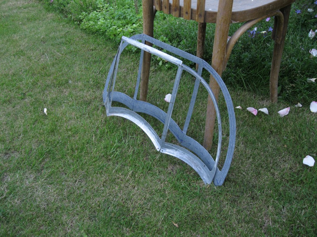

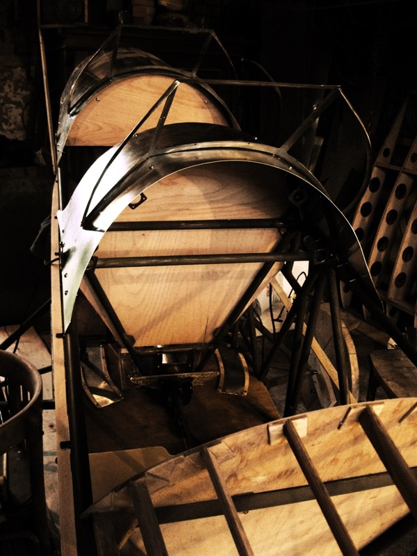

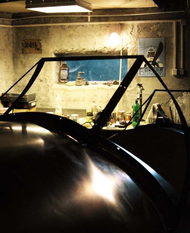

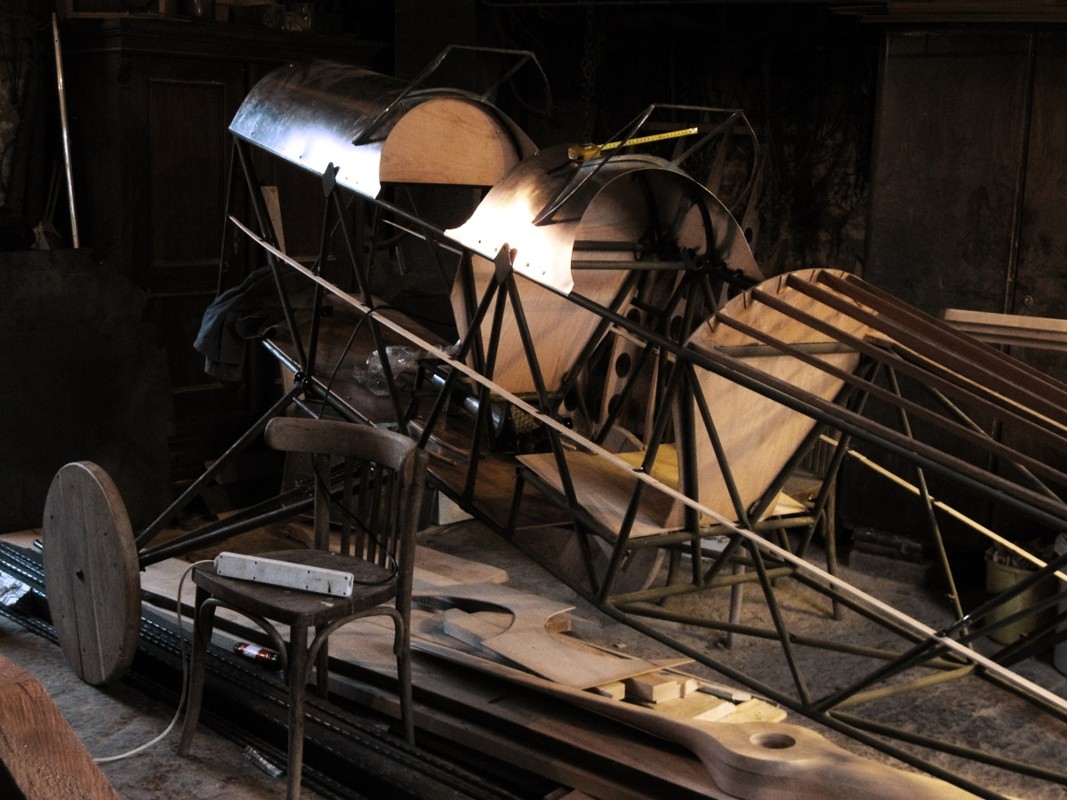

Some updates for you :D
Welcome to Vasek's Aircraft Industries :D
My production of WW1 propellers, trophies and constructions:
http://forums.matronics.com/viewtopic.php?p=424665#424665
http://forums.matronics.com//files/140504a_0004_563.jpg
http://forums.matronics.com//files/140504a_0001_445.jpg
http://forums.matronics.com//files/140504a_0003_441.jpg
http://forums.matronics.com//files/140504a_0002_177.jpg
