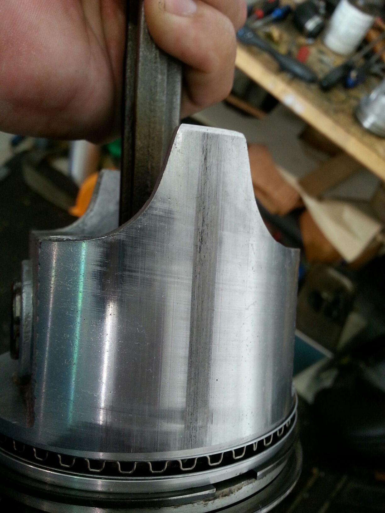

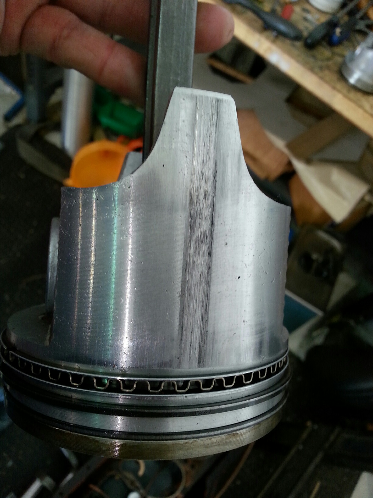

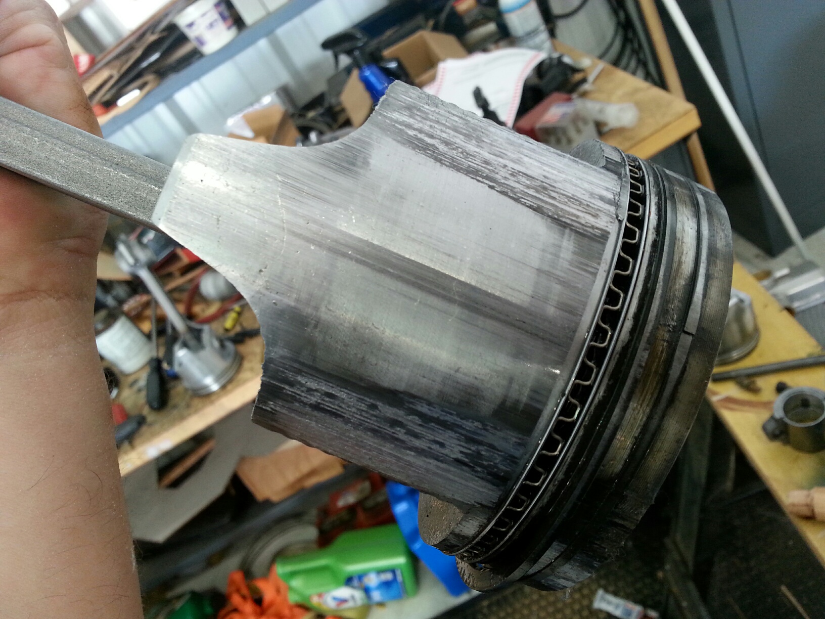

      Rich Built My engine too.. and I still feel like he does great work.
      I just got an email back from him and he says .003 and that's where mine were.
      So do I have a clearance problem ? I took the bad piston to a friend yesterday
      and just said "what do you think" he says it looks like it got tight.
      and the discussion went to A-65's and back to "open it up" and that a looser fit
      wouldn't hurt anything
      here are pics... labeled 1-2-3
      #1 is nearest the prop
      jeff

      Hey,
      After looking at these pics.  I am wondering if the rod bearing were put in the
      rods backwards?  Was the bearing with the oil hole installed on the rod end,
      or in the cap end.  The bearing with the oil hole should be installed in the rod
      side to provide oil to the piston pin and help cool the piston. It seems like
      a no brainer but I have seen stuff like this happen more than once.

| Subject:  | Re: model A engine |
      With gaulding like that you will need to hone the block out before reassembly.
      Just doing that will give you more clearance.
      Curious... two rubbed at the widest point, the other was just the opposite...
      Baffled.  Did you ever find out if they are cast or forged pistons?  That could
      explain the need for more clearance.

      I have seen these same problems first hand. I have been working on building a new
      engine with the help of my engine builder and we have been worried about the
      new aftermarket "China" pistons. Decided to have Ross make new forged pistons
      and they said they need at least 9 thousandths wall to piston clearance. Also
      for a airplane running a prop he did not like how the thrust washers go in and
      the bearing clearance for the insert mains. We are changing all. He also said
      he can improve the oil system a lot which we are doing. Got a new Scat crankshaft
      and rods which are way better than other new overseas made balanced crankshafts.
