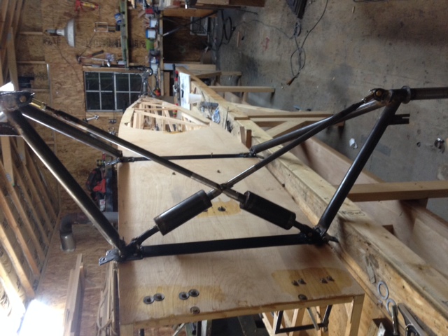

Over the years we've seen just about every size and type of forward diagona
l struts used on Pietenpol center sections
in lieu of the X-cable bracing that is shown on the plans to keep the four
cabane (and thus wing) erect, upright, and to keep
it from shifting forward in the event of a crash but what is somewhat distu
rbing is seeing very small diameter tubing used here
in such a critical area.
If those diagonal struts are too small or not strong enough the wing will c
ome forward in an accident involving a high rate of
deceleration. Don't whimp out on what size tubing or strut material you're
using up there----it could save your life or ruin your day
and a passenger's day.
Mike C.

| Subject: | Re: a common place to undersell yourself---diagonal struts |
If you see carefully the first photo, it have the X braced cables too.
And the second one is strong enough as the bolt it have in the upper side,
It look thin.

Mike,
In the interest of improving the "crash-worthiness" of my Pietenpol, I've
decided this winter to replace the cabane diagonals on mine, per William
Wynne's suggestions after his experience. While my diagonal struts are
plenty beefy, and the attach points to the front cabane struts are good and
solid (see photos below),
the weak point in the system is the turnbuckle fork that I used to allow for
easy adjustment of the wing. In the event of a crash, any forward movement
of the wing will likely buckle the turnbuckle fork shaft. I will remake the
struts with the streamline tubing going all the way to the attach point, now
that I have the wing where I want it.
Wing movement in a crash is not much of a concern with a nose mounted tank
(of course, having a tank full of fuel in your front passenger's lap might
be something to worry about). But with a centersection tank like I have, it
won't take much motion to rupture a fuel line and cause a fire.

(of course, having a tank full of fuel in your front passenger=99s la
p might be something to worry about). But with a centersection tank like I h
ave, it won=99t take much motion to rupture a fuel line and cause a fi
re.
> Another point to consider is that using streamline tubing produces much le
ss drag than round tubing (there is almost no worse shape moving through the
air than a round tube), but the round tube is much cheaper. Trying to redu
ce drag on a Pietenpol is pretty much a losing proposition.
> Anyway, this is a good discussion to have for those who are in the buildin
g process and making decisions on how to brace their wing structure.
> Jack Phillips
> NX899JP
> Smith Mountain Lake, Virginia
> From: owner-pietenpol-list-server@matronics.com [mailto:owner-pietenpol-li
st-server@matronics.com] On Behalf Of Cuy, Michael D. (GRC-LME0)[Vantage Par
tners, LLC]
> Sent: Wednesday, July 09, 2014 9:29 AM
> Subject: Pietenpol-List: a common place to undersell yourself---diagonal s
truts
> Over the years we=99ve seen just about every size and type of forwar
d diagonal struts used on Pietenpol center sections
urbing is seeing very small diameter tubing used here
> deceleration. Don=99t whimp out on what size tubing or strut materi
al you=99re using up there----it could save your life or ruin your day
> and a passenger=99s day.
> Mike C.
> Ohio
> <image009.jpg> <image010.jpg>
> One I would not let someone I loved ride in.
One I would gladly let someo
ne I loved ride in.

I am thinking about re-doing mine also. I am inviting all comments/criticis
ms on my design, in order that I might make some improvements. Please feel
free to comment as you wish,.... but.... please ....if people could possibl
y refrain from using the words "1960's swing-set technology".........don't
think I can withstand the rejection again.....
Dan Helsper
Puryear, TN
-----Original Message-----
From: Jack Phillips <jack@bedfordlandings.com>
Sent: Wed, Jul 9, 2014 8:52 am
Subject: RE: Pietenpol-List: a common place to undersell yourself---diagona
l struts
Mike,
In the interest of improving the =9Ccrash-worthiness=9Dof my Pi
etenpol, I=99ve decided this winter to replace the cabane diagonalson
mine, per William Wynne=99s suggestions after his experience. While
my diagonal struts are plenty beefy, and the attach points to the frontcaba
ne struts are good and solid (see photos below),
the weak point in the system is theturnbuckle fork that I used to allow for
easy adjustment of the wing. Inthe event of a crash, any forward movement
of the wing will likely buckle theturnbuckle fork shaft. I will remake th
e struts with the streamlinetubing going all the way to the attach point, n
ow that I have the wing where Iwant it.
Wing movement in a crash is not much of aconcern with a nose mounted tank (
of course, having a tank full of fuel in yourfront passenger=99s lap
might be something to worry about). But witha centersection tank like I ha
ve, it won=99t take much motion to rupture afuel line and cause a fir
e.
Another point to consider is that usingstreamline tubing produces much less
drag than round tubing (there is almost noworse shape moving through the a
ir than a round tube), but the round tube ismuch cheaper. Trying to reduce
drag on a Pietenpol is pretty much alosing proposition.
Anyway, this is a good discussion to havefor those who are in the building
process and making decisions on how to bracetheir wing structure.
Jack Phillips
NX899JP
From:owner-pietenpol-list-server@matronics.com[mailto:owner-pietenpol-list-
server@matronics.com] On Behalf Of Cuy, Michael D. (GRC-LME0)[Vantage Partn
ers, LLC]
Sent: Wednesday, July 09, 20149:29 AM
Subject: Pietenpol-List: a commonplace to undersell yourself---diagonal str
uts
Overthe years we=99ve seen just about every size and type of forward
diagonalstruts used on Pietenpol center sections
inlieu of the X-cable bracing that is shown on the plans to keep the four c
abane(and thus wing) erect, upright, and to keep
itfrom shifting forward in the event of a crash but what is somewhat distur
bingis seeing very small diameter tubing used here
insuch a critical area.
Ifthose diagonal struts are too small or not strong enough the wing will co
meforward in an accident involving a high rate of
deceleration. Don=99t whimp out on what size tubing or strut material
you=99re usingup there----it could save your life or ruin your day
anda passenger=99s day.
MikeC.
Ohio
OneI would not let someone I loved ridein.
One I would gladly let someone
I lovedridein.

>I bought two cork floats from ACS. I took one, coated it with either T-88 o
>r varnish, (Don't recall which...) and found out during the fuel flow tests
>, it sinks.- The "gauge" consists of the cork float and a thin wire passi
>ng through it.- I plan to test the other cork, as is, from ACS and hope i
>t floats. Any other suggestions?=0A=0A-=0AIf God is your co-pilot, switch
> seats=0AMike Perez=0AKaretakerAero=0AFirst engine start complete!
>________________________________ Message 6 _____________________________________
>Time: 07:08:27 AM PST US
>From: "Jack Phillips" <jack@bedfordlandings.com>
>Subject: RE: Pietenpol-List: Fuel Float...Doesn't
>What is your wire made of? I found that a steel wire requires a vry large
>cork to support it. I made my wire out of aluminum, and just melted a ball
>on the end with my oxy-acetylene torch and painted it balze orange. I
>coated the cork and the paint on the ball with epoxy varnish. After 10
>years it hasn't sunk yet.
>Here's a picture that shows my fuel gage as seen from the rear cockpit:
>Jack Phillips
>NX899JP

>I bought two cork floats from ACS. I took one, coated it with either T-88 or
>varnish, (Don't recall which...) and found out during the fuel flow tests,
>it sinks. The "gauge" consists of the cork float and a thin wire passing
>through it. I plan to test the other cork, as is, from ACS and hope it

>Cork is pretty rough and porous. Not sure coating it helps. It's nigh near inevitable
>that there's gaps in coverage UNLESS you really coat it thickly with
>epoxy, which'll make it a lot heavier and even less able to support weight.
>Is the cork you bought designed to hold an indicator UP out of the fuel (as in
>a nose tank), or hang DOWN (as into a transparent sump in a wing tank) into fuel?
>The latter can be smaller.

>Hi Jack. My float is in the tank, passing through the tank cap. (Nose mount
>ed tank.)- I thought that maybe the clearance between the wire on the cor
>k and the tube is slides in, through the cap, was too tight. So I held it i
>n hand and stuck it into a jug of 100LL and it sank!- I believe the wire
>is S.S. welding rod. I just measured a .062" dia. welding rod I have here n
>ow, I believe my float wire is thinner.=0A=0A-=0AIf God is your co-pilot,
> switch seats=0AMike Perez=0AKaretaker Aero=0AFirst engine start complete!

>Congratulations on your solo and engine run Mike P.
>If the cork is dipped in shellac, allowed to dry one day between coats, and
> given 2-3 coats it will be impervious to avgas for
>many years but will not be impervious for auto fuel that contains ethanol.
>Mike C.

>The float is 1.5" long by 1.0" diameter. It came pre-coated/drilled, but it
> seemed to me that the coating was so thin and "broken" that it would not s
>eal.- (Did I test it prior to coating myself...ah, nope...doh!)=0A=0A-
>=0AIf God is your co-pilot, switch seats=0AMike Perez=0AKaretaker Aero=0AFi

>Thanks Mike!- I copied your fuel "gauge" almost exact...guess I missed so
>mething. From the pictures I have of yours, it appears you used only one co
>rk, correct?=0A=0A-=0AIf God is your co-pilot, switch seats=0AMike Perez

>I actually shaved/belt sanded two corks so that they would fit in the fuel
>filler neck
>and then epoxied them end to end, inserted the float wire and pulled the j-
>hook into
>the bottom and then started applying the shellac coats.
>Mike C.
>Ohio

>AH!- I only used a single.=0A=0A-=0AIf God is your co-pilot, switch sea

Message 17
| Subject: | Landing gear about finished |
I finished my landing gear last night ... I built the die spring type gear that
BH used on the last original. It has been quite a task to complete, but I
am pleased with how it looks.. I hope it performs ok.
http://forums.matronics.com/viewtopic.php?p=426407#426407
http://forums.matronics.com//files/landing_gear_finished_1_276.jpg
Message 18
| Subject: | Re: Landing gear about finished |
Kenny;
Wow! Nice job on the gear. Just wondering (it's not obvious from the photo),
did you crank in a little bit of angle on the axles so when the completed airplane
sits on the gear and the springs compress under the weight, you'll still
have a little positive camber (top of the tire pointing out, not in)? I am presently
having to add some tapered axle shims to restore the positive camber to
my gear, since the tires have been wearing a bit unevenly. I don't know if
the springs on my gear legs have weakened and compressed a bit or what.
Oscar Zuniga
Medford, OR
Air Camper NX41CC "Scout"
A75 power
http://forums.matronics.com/viewtopic.php?p=426409#426409
