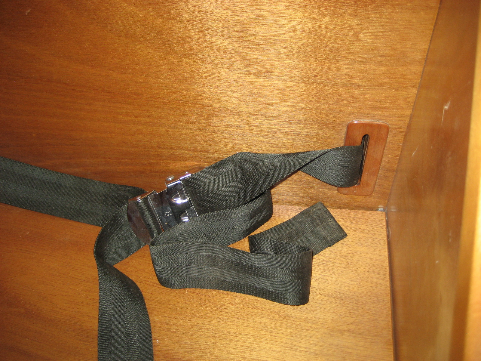

Mounted my lap belts as you described through wood with extra 1/8" ply on each
side. My shoulder belts attach all the way back to my AN6 tailwheel attach bolt
with a 1/8" cable in between.
Rick Holland
NX6819Z
http://forums.matronics.com/viewtopic.php?p=426449#426449
