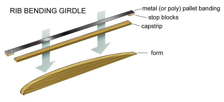

Tools, I am not quite sure I follow your explanation. The first sentence:
--"Wood fibers can be crushed, they CANNOT be stretched."=0AThen Later"
Something as simple as nylon packing tape along the outside radius, will (h
elp) prevent any stretching there,..."If God is your co-pilot, switch seats
=0AMike Perez=0AKaretaker Aero=0AJury Strut Fabrication/Installation

Mike=2C Tools is correct. Even with all the soaking and steaming=2C you can
only get=2C at best=2C a 2-percent stretch from wood. Some wood=2C not all
. This means that if you try to stretch it=2C it WILL fail. But the soaking
and steaming can make it a bit squishy in compression (Tools' term 'crushe
d' implies failure. We're not looking for failure=2C just compression.)=2C
and it will take a permanent set when the heat/steam/moisture is removed.
When you bend a stick=2C the neutral axis is along the center. The outer ha
lf is in tension=2C and the inner half is in compression. Make too much ten
sion - failure. Exactly what the photos of my failed capstrips show. The te
chnique Tools presented was to connect another strong=2C rigid material to
the outside of the bending wood=2C before it is bent=2C to move the neutral
axis all the way to the outside of the bend=2C thus putting all the load o
n your bent piece of wood into compression. This technique has been used by
furniture makers for centuries.

Hey Mike, not the most intuitive thing... let me try to explain.
First, does the explanation about when you "free bend", meaning just hang onto
a piece of wood and bend it, that the outside half of the wood is in tension,
the middle of the wood is neutral, and the inside is in compression?
This is a basic force diagram sort of thing for a beam across a span sort of situation.
To give a better verbalized pictorial, assume the beam is being held on the ends,
in the middle. As in they taper to a point and are being supported by those
points, near the center of the beam.
As the beam bends from gravity (or a load), the outside radius is in tension.
The beam is trying to stretch. The middle sees no compression or tension, only
bending. The inside of the radius sees compression, the force resisting bending
is that the beam resists getting compressed.
If you support that beam at the bottom, as in just set it on the wall, the beam
is (sort of...) forced into resisting bending ONLY due to compressive forces.
If you bolt a little tab onto the beam's upper surface, and support it from there
(as in hang it down between the walls), the beam resists bending due to tensile
forces. It trys to stretch, but beams don't stretch usually...
In all cases, the force is the least at the point of support, and gets bigger the
further away from the support you go.
In the case of wood cells, they simply cannot stretch, at all. They can resist
stretching until the point of failure, but they won't get longer, it will just
fail. Natural fiber rope is safer because it doesn't stretch before failure,
similar to wood fibers. Synthetic ropes will stretch before failing and can
be lethal on ships. Crop dusters would rather hit aluminum lines (power lines)
because they just fail, they don't stretch like old phone (copper) lines do.
Wood cells can crush. If they're dry enough, they just break. If they're pliable
enough, they sort of just squish, the cell wall stays in tact. That's why
dry wood doesn't bend as well as wet wood. This is relative, ALL wood is wet
to some degree.
Dry rot is a fungus, and has nothing to do with dry, by the way...
So.... to bend wood effectively, we need to make sure when we bend it, we support
the wood at the outside of the radius. If you take a piece of metal pallet
strapping, longer than the piece we're going to bend, and put "end stops" on
it, VERY well attached so they cannot slip along the metal strapping, spaced apart
the SAME size as the blank of wood we're going to bend (so you can't use
random length pieces and cut them to size later, you can cut to size later, but
all the blanks used in this jig HAVE to be the same size for it to work, needs
to fit snug), we have an effective wood bending jig.
Put the wood in it (steamed, boiled, wet off the tree, just not super dry - certainly
not 8 percent out of the kiln and left indoors in a dry environment) and
bend. Those end stops will FORCE the entire wood bending action into compression,
thusly making it work. If the wood fails, it won't fail along the outside
of the radius like in the above photos, it may experience a compression fracture,
see my post about fixing a horiz stab a few months ago, and you'll see
that on the INSIDE of the radius. That would indicate the wood is too dry to
bend.
Strapping tape basically doesn't stretch, and the bends and wood we're talking

Message 17
| Subject: | Re: Building Wing Ribs |
I did a quick sketch of a bending strap to move the axis of the bend to the outside
edge of rib and put all fibers in compression. I was thinking of using 1/2"
pallet banding, and in re-reading tools description of old furniture bending
straps, it sounds exactly the same...doggonit, thought I had came up with something
for a minute! Anyway, I guess the downside is, you would have to cut
your rib exactly to size so compression would begin immediately as bend is started,
but hey, these ribs are chocked full of precise cuts anyways-what's one
more!
Jon Jones
Ironton, MO
http://forums.matronics.com/viewtopic.php?p=428520#428520

Message 18
I read tools latest post AGAIN, and see where I drew what he was describing down
to the last detail, pallet strap, blocks and all, so let me start over---
"Tools, I made a drawing of the process you described..."
Jon Jones
Ironton, MO
http://forums.matronics.com/viewtopic.php?p=428522#428522
Message 19
Clever. I like it. But too late for me.
Lorenzo

Message 20
Mike, seriously?!! All that for nothing! Good one...
Still, a good discussion on what's going on when ya bend wood. Wing bows, rib
caps, etc. GREAT diagram of how to make a bending jig. The jig doesn't have
to be precise, the end blocks can be adjustable... or use shims. The part just
needs to fig snugly.
Another trick, ammonia. Use that alot for bending balsa wood in model building.
Not sure what's going on, need to check with a bud who's a wood technologist.
http://forums.matronics.com/viewtopic.php?p=428525#428525
