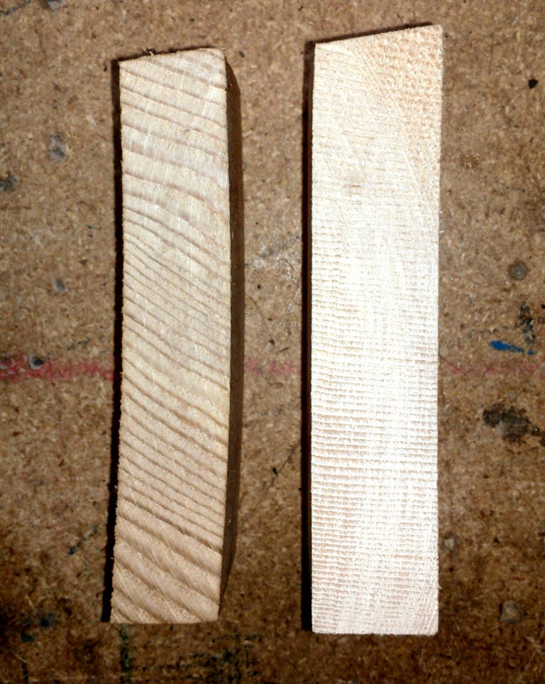

Hello Good Piet-Ple,
Well things are back on track with my 1931 Pietenpol project - after
having taken a few brief steps "backwards" by replacing the two rear
spars.
The first image shows the previous and current spar sections. The spar
on the left was the one the original wing builder installed. (I bought
my wings from another builder who had started a Pietenpol project.)
But that particular spar was not up to the fine quality of the rest of
his wing construction. The "cup" in the spar section in particular was
making it difficult to integrate the spar with the wing
center-section, and wing strut fittings. So I replaced both rear
spars. (See other writings for my spar/router screw-up adventure.)

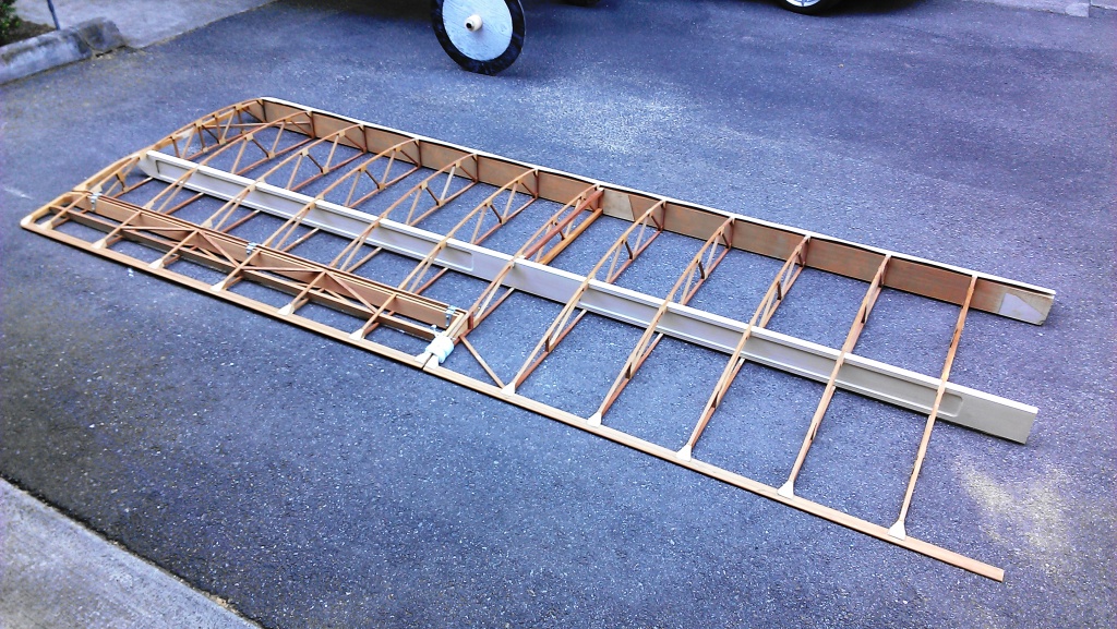

I now have a new set of routed rear spars that are glued in place. I
used a new 3M "dispensing gun" to apply the aircraft-grade structural
T-88 epoxy. The special tips mix the resin/hardener in the tip itself
as you dispense it from the gun - which eliminates all the mixing/mess
of using epoxy in from large bottles. Depending on the aspect of the
project, this gun may be more effective than glue from large bottles
mixed in the traditional manner. It was certainly more expensive to
use these special tubes, but it worked really well for gluing the
spars.
Next step in the project is to get back to joining these wing sections
to the center-section spars - the step I was beginning before I chose
to replace the spars. I feel good about the choice to do so - even
considering the setbacks.

Looks nice Jake.- That feeling of being satisfied after having to do re-w
ork is a good thing...even though the process of doing the rework may not b
e so gratifying.=0A=0AI really like the wood wheel landing gear in photo tw
o...nice and light weight.=0A=0A-=0AIf God is your co-pilot, switch seats

Jake,
Nice! Can I ask what the front spar dimension is - as it seems to be full thickness
without any routing.

One way of securing the front of the horizontal stabilizer to the upper lon
gerons.
[cid:image001.jpg@01CFBBAC.1D3EFCF0] [cid:image002.jpg@01CFBBAC.1D3EFCF
0]

Yes, the front spars have no routing. I do not have the height number, but they
are about 0.9" thick. My rear spars are a full 1.0" and were routed with 1/4"
deep pockets.
